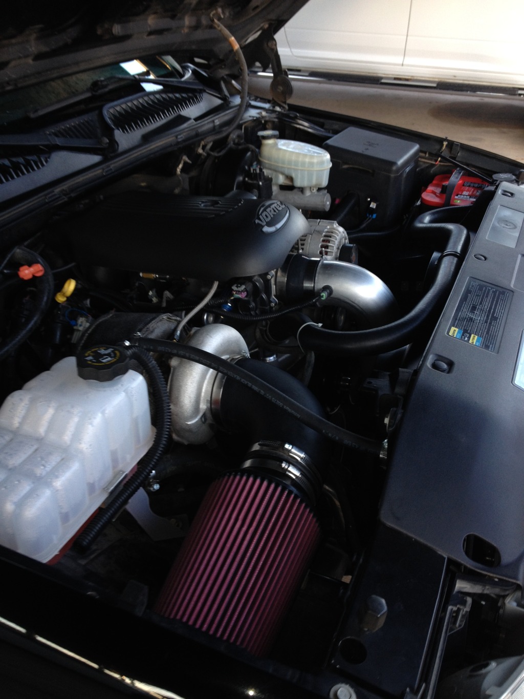

Decided to share a few pics of my 03 build. Still coming together but making progress. As soon as i get some time, I'll be doing head studs, ls9 gaskets, ls7 lifters, cam swap, and more boost.

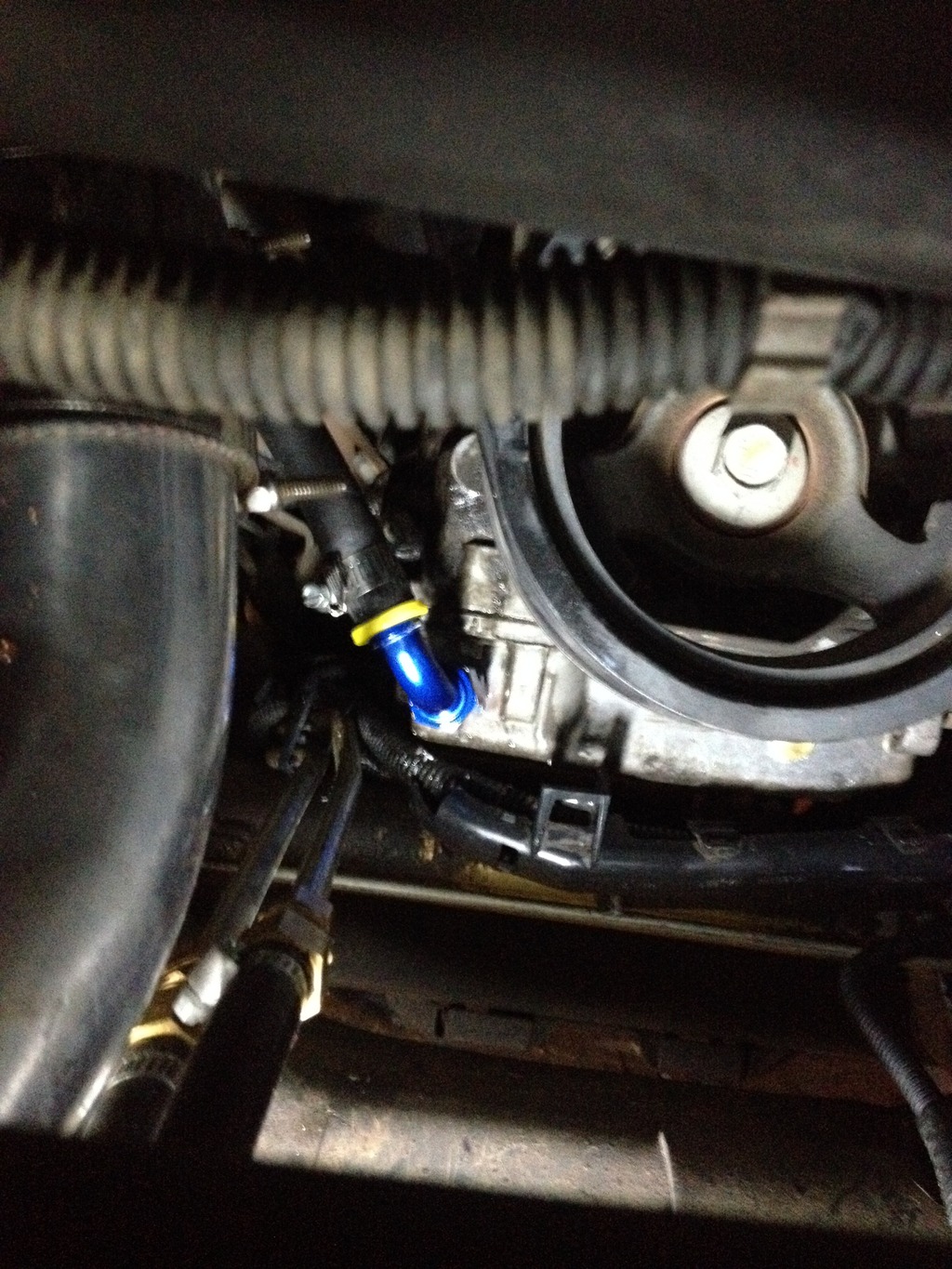

Looks good.
Those trans lines scare me though.

I need to grab a new pic...I have braided line now from the trans to the trucool.

Looking great. I may have missed it but how many pounds of boost you running? Also, I would recommend doing LS9 head gaskets. LS3 won't really buy you much.

I'm currently running 8 psi...i meant to put ls9 gaskets...long day lol

Looks good. Is that pushloc hose on that drain fitting? If so youre not supposed to use hoseclamps on it. It will actually cause the barbed part of the fitting to cut through the hose n cause a big ole mess.

Looks good Have anymore engine bay pics? How did you run the intercooler? Turbo setup specs?
