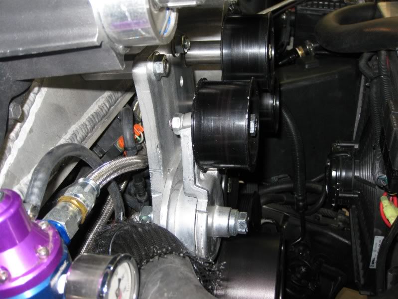

WTF

Looks like .10" difference in offset between the 3.0 and 3.4 pulleys. Funny thing is I pulled off the 3.0s when I received the blower setup and put the 3.4s on to start out with less boost. The 3.4s have the correct offset.

How is your tensioner/s supported?
Old Apr 23, 2010 | 07:17 PM
  #29
DrX's Avatar
DrX
Joined: Jun 2005
Posts: 2,703
Likes: 6
From: Canada
Dropped off the pulleys at the machine shop.
