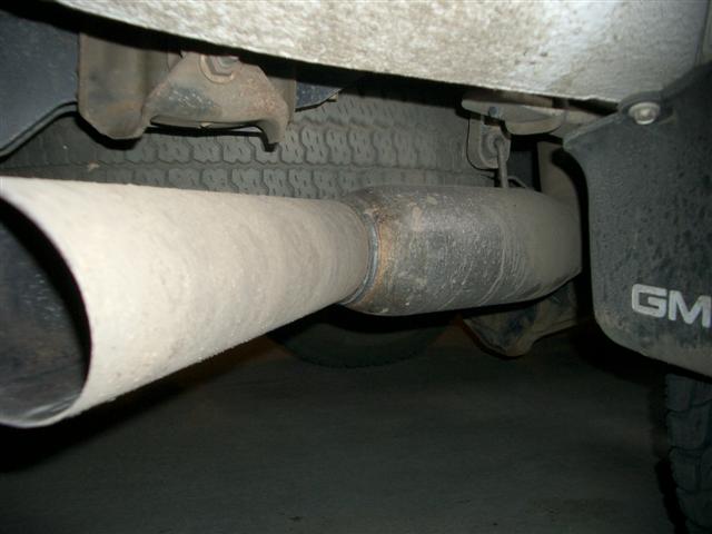

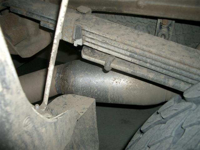

Some of you may be wondering why even check it, just install the best flowing exhaust you can. Reason is this... I have stock piping and the best Flow Pro Muffler money can buy for flow and quietness. I always thought it was nice a quiet, but after towing with my Radix I have changed my opinion. It is still very good, just louder than stock. It gets so droany at a certain RPM, say when it is towing going up small hill and loaded good. I have to shift it into 3rd or slow down to lower RPM or else my 10 month old wakes up a looks at me as if I was the devil. Not good. So I installed a 3.5" straight through race muffler on the tail pipe. Right beside spare tire. Flo Pro is still on there too. It fit okay and looks very nice. All welded and everything. It is way beter so far, I have not towed yet but even around town it is way different. Now I am not sure if I lost a bit of power, or if it is the heat outside and A/C on or what. So I may check exhaust pressure and see. Someone tell me if I am waisting my time here, is there perhaps a beter way?
