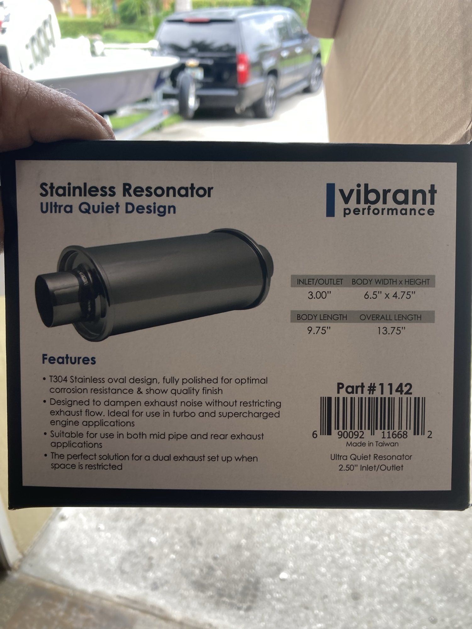

Made a huge difference.

I'm running 2 vibrant resonators. They freakin work...

I used their largest resonator on my 4" exhaust with a AP Exhaust 36" diesel muffler and it was still kinda loud. But thinking back i think that was because of the turn down at the bumper vs a tail pipe..
Ill have to give it a try and report back haha

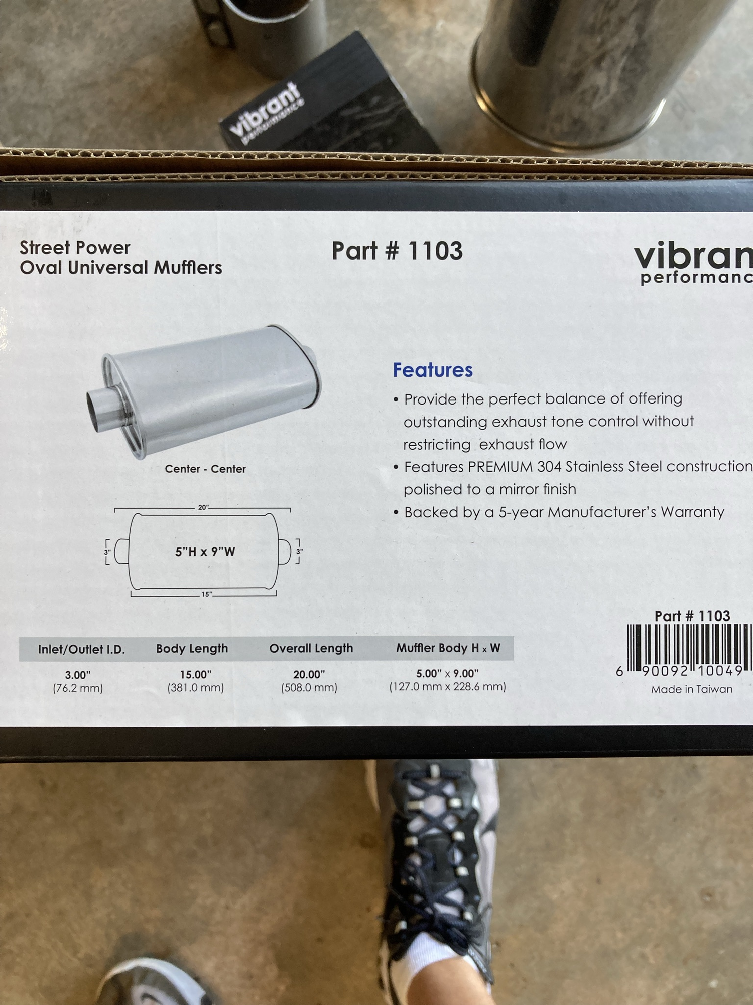

This also worked really well on mine to knock down the sound significantly.
