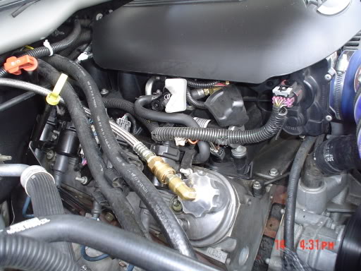

I know someone else with one of these! What a great product and piece of mind for a leak free oil system! Thanks again BLUE01 !!!!!!!!! THIS IS HOW THE KIT SHOULD COME!!
