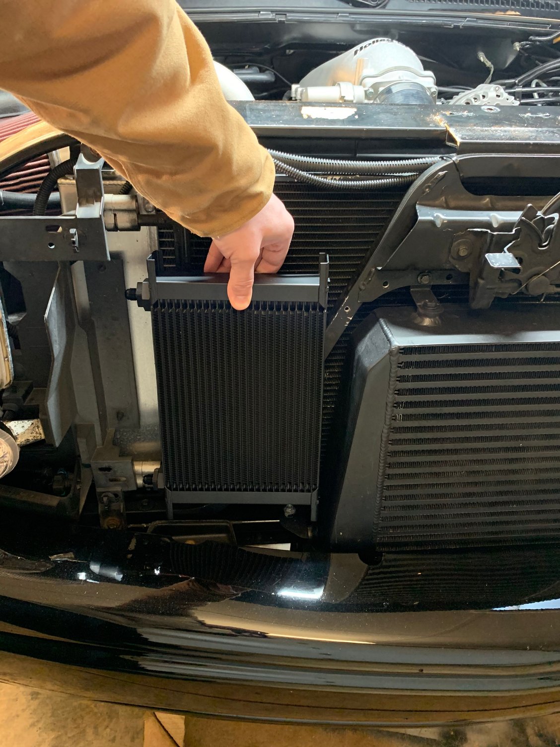

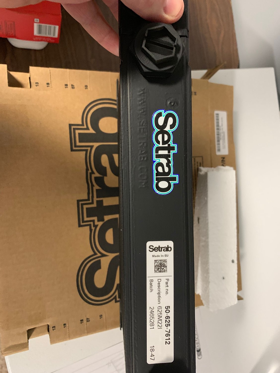

I haven’t been happy with my trucool under the bed, I even have fans on it. I am switching to a Setrab cooler that I can fit in the front with my 4” intercooler and we shall see how that does.

How much less efficient is that setrab? It still looks pretty decent size. Maybe have a part number?

The construction of the setrab appears to be way more efficient, it has way more rows and internally looks to flow a lot more

Threw the IC mounting bracket that came with the kit away and made my own. Flipped the intercooler over and mounted it more forward, right up next to the back side of the grill. 40k now fits in between the condenser and intercoole with again 3/4” in between each other.
ill try to get pics this weekend if I remember
