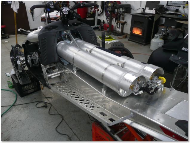

Its a thick steel tank designed to be bolted into the back of a pick-up truck, bolted into the back of a pick-up truck... Now my sled, that was a different story
Thank you Kyle, it has come a long way!
