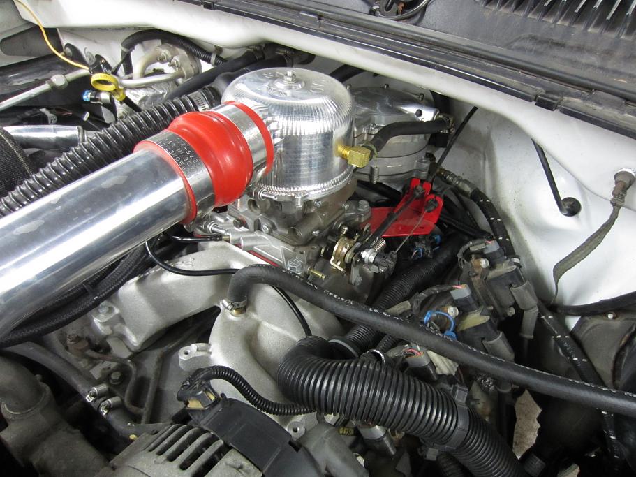

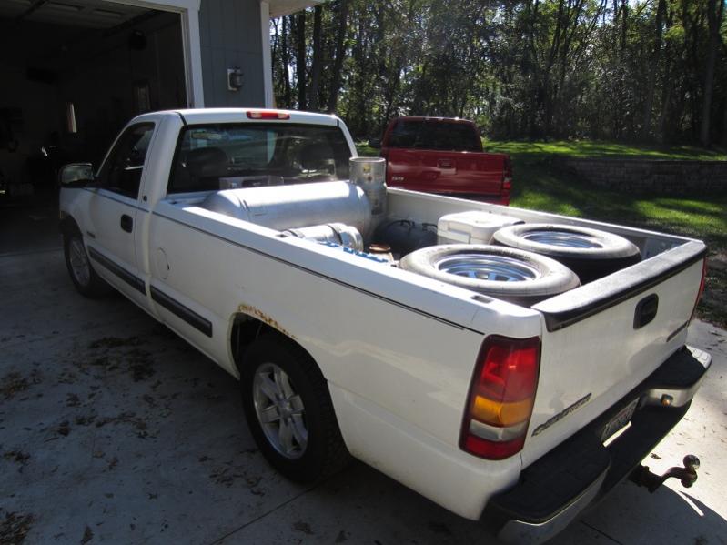

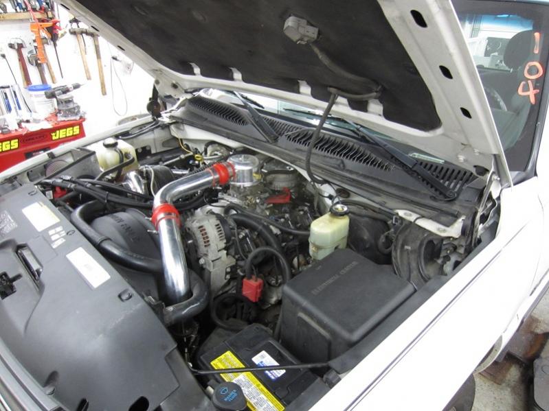

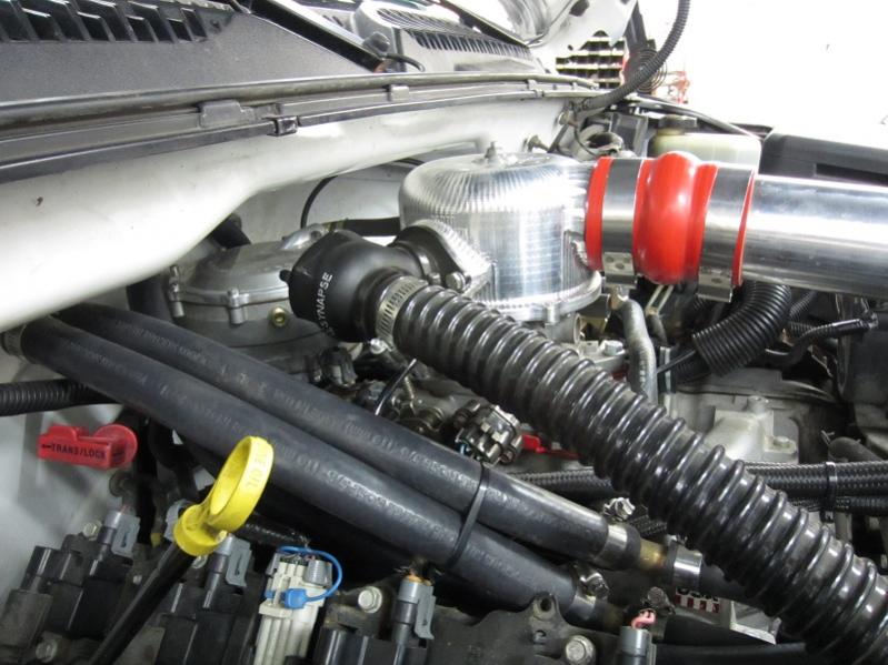

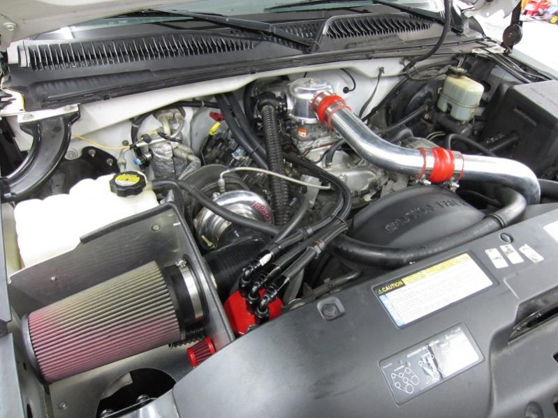

Thanks guys, it's been a fun build and a great daily driver. Those two runs were the 13th and 14th time I've ever been down a track, first time ever on slicks so needless to say there plenty of things I can do to make my goal of 11.5 second propane daily pickup. I need to start a build thread soon with all the details but for now here's some more photos and video. I'll update my sig soon too.

That looks like a standard LP Regulator, who makes it? I used to work on LP systems on industrial equipment. If it is a standard regulator, I would have never guessed it would fuel that setup. Pretty Cool.

Congrats on the #'s. I agree its a great $ savings but I hope that tank never lets go. Cause that big tank will make a nice mushroom cloud. Just not worth the added risk of possible death with propane in my eyes. Good Luck with it.
