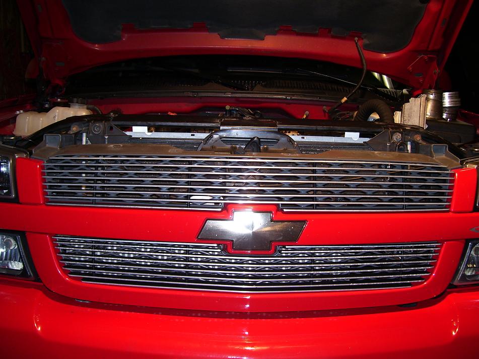

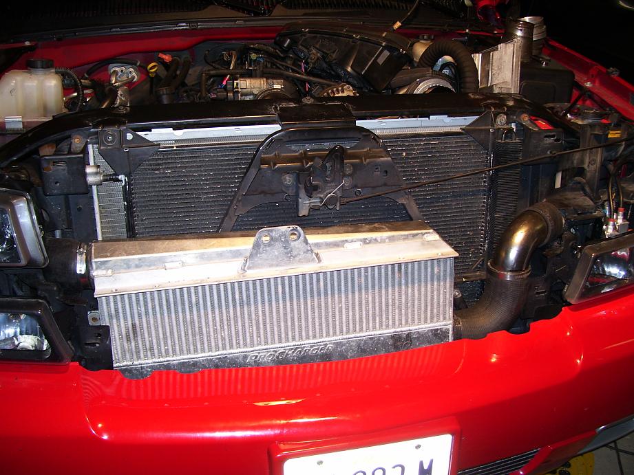

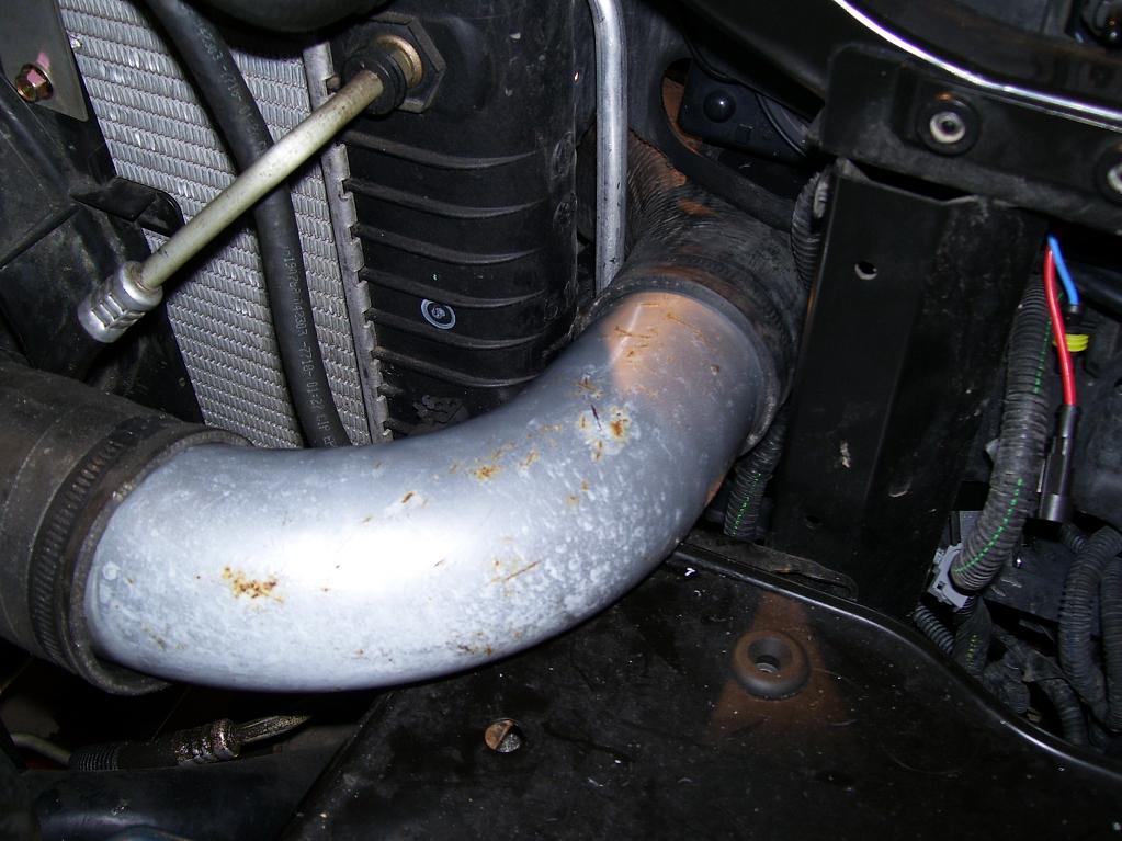

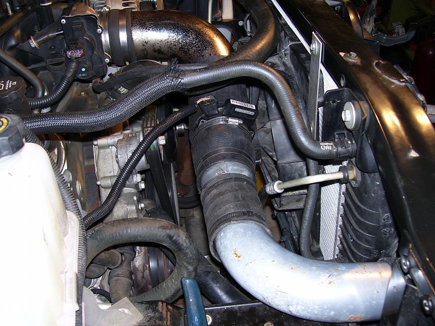

Here are some pics,I ended upswitching to an ebay intercooler that had the inlet and outlet on top and all hard pipe without rubber elbows,but now I am going air/water so I don't have this setup anymore.when I did this I wanted to get plenty of air through the grille since my bumper cover didn't seem to have much airflow for the intercooler. I offset it to try not to obstruct the radiator too much.
