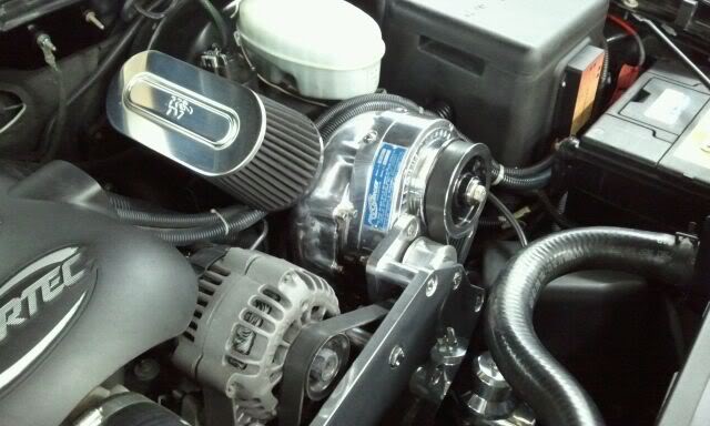

This is what I have. Get comps on it alot.

Not off the top of my head, but it is used on marine set ups, google K&N 496 MPI in images, you should see it.

Yes I have a 90 that fits the procharger collar, then have a aluminum reducer to put in that, it reduces down to fit in the filter.
K&N Flame Arrestor for 496 :: Flame Arrestors :: Diamond Performance Parts

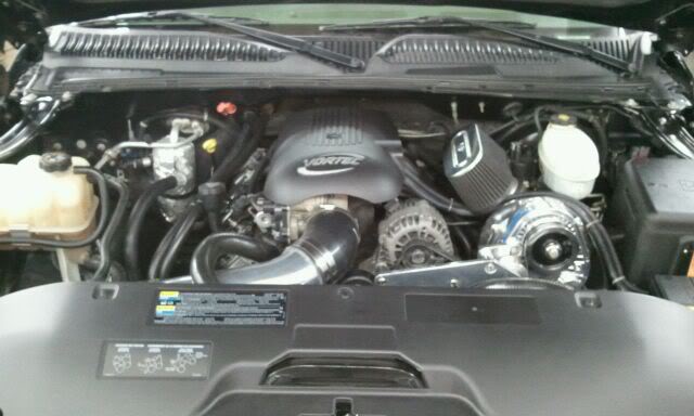

this is what i got going...

I could see that getting destroyed using as a daily driver. I thought about that, but then thought again.

^^I would consider that at the track where it's a controlled environment but not as a DD. It doesn't take much at all to destroy an engine and those could let a very small pebble or something through.

lol yeah i wouldnt recommend dd it like this, but dam does it make a difference .
