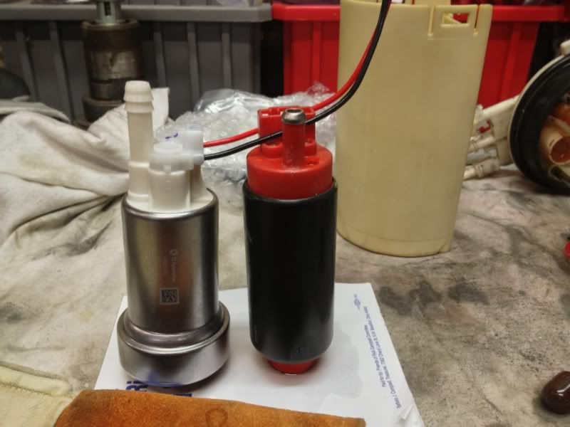

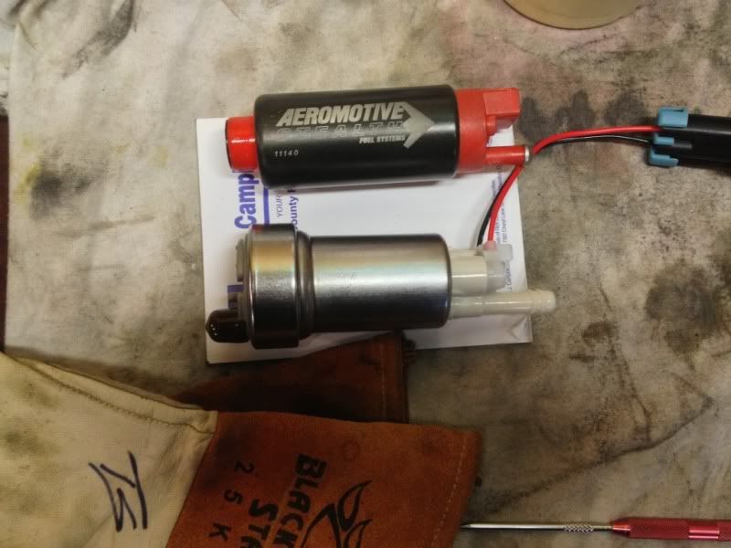

Yeah that pump you have is not a 450 walbro
Here is what one looks like , bottom one , from when I swapped out from a 340 ( top)
What's the dimensions on that Walbro? Will two of them fit?
I was also considering an AEM that does something like 320lph. Scoggin Dickey has them. They are also an E85 pump.
Is there a check valve in there too?
