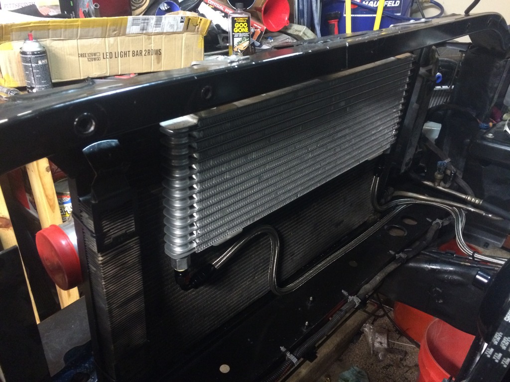

Originally Posted by iDEALS1

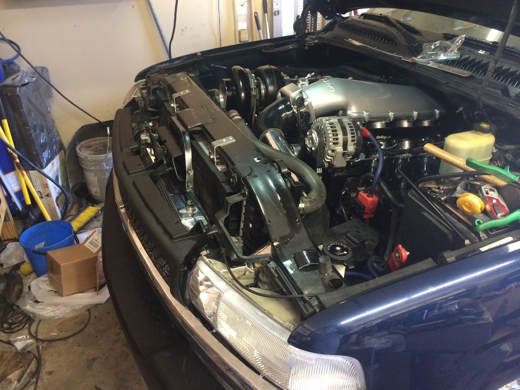

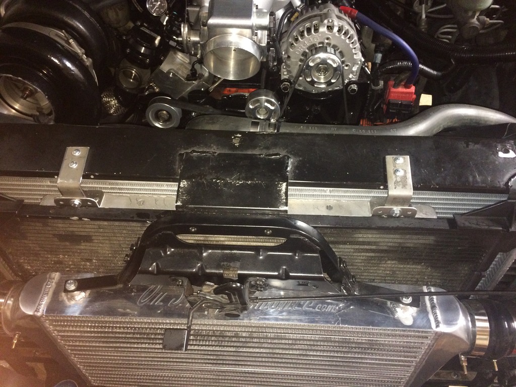

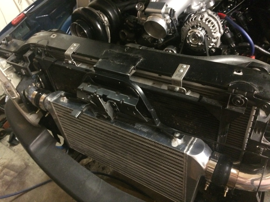

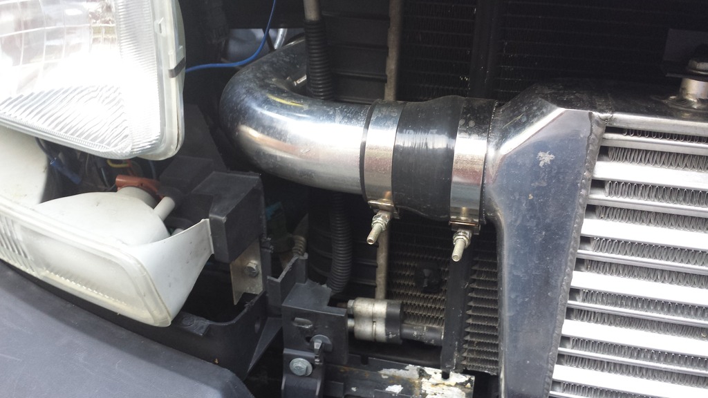

On my 2000 I put the cooler between the radiator and condensor. It fits perfect, but you just have to make some brackets. I will get some pics when I get home from work if you would like.
These are the pics of how mine is fit together.

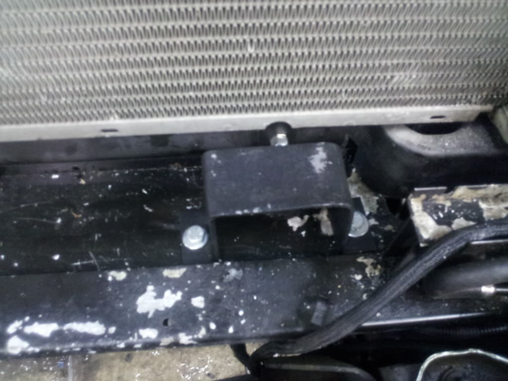

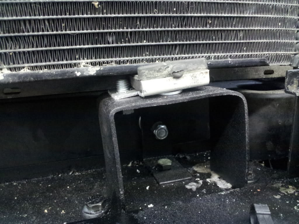

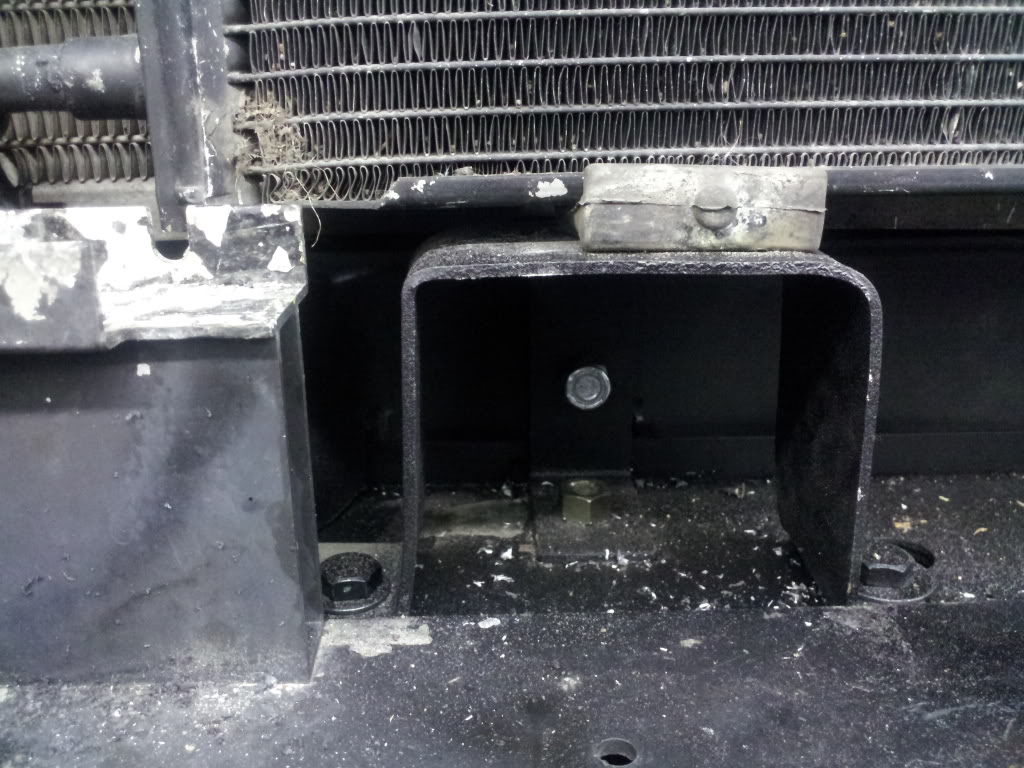

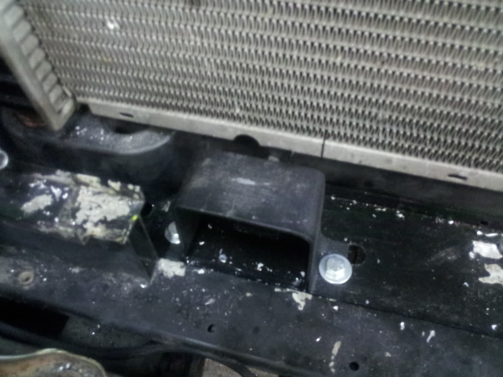

You can see here how far back the condenser is compared to the old mount
These are the new condenser mounts, and in the back ground you can see the new mount holding the radiator mount, what I did with that is I cut notch in it so it would sit further back in the radiator support, so i just moved that whole plastic piece back an inch or two
