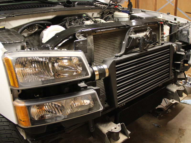

Here is a pic of mine im working on. I dont run ac tho. Ive seen guys mount them behind the bumper at an angle below the intercooler. Seemed to work for them.
[IMG]
[IMG][/IMG]

Heres mine where the condensor used to be and an oil cooler in the same plane in the top right
I used the intercooler itself to hold the hood down.
