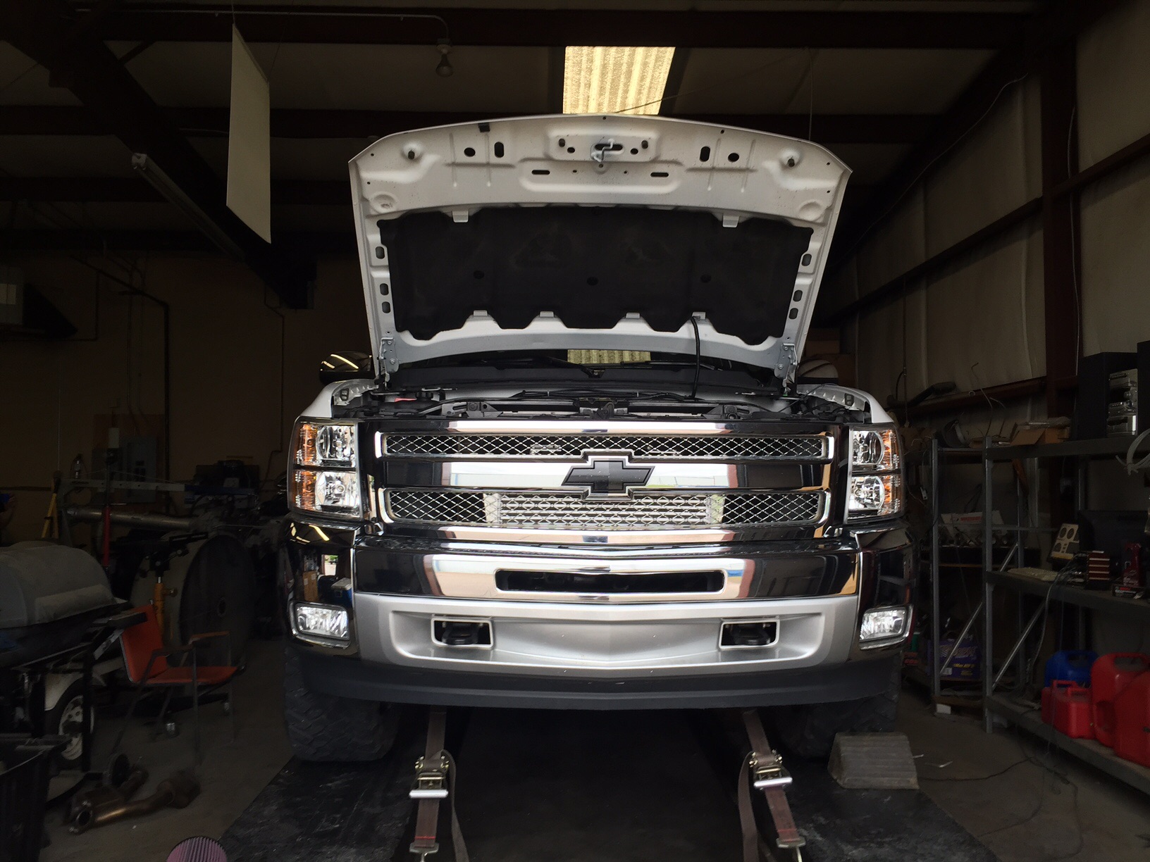

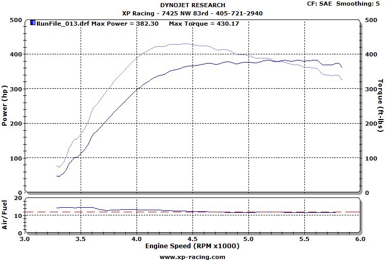

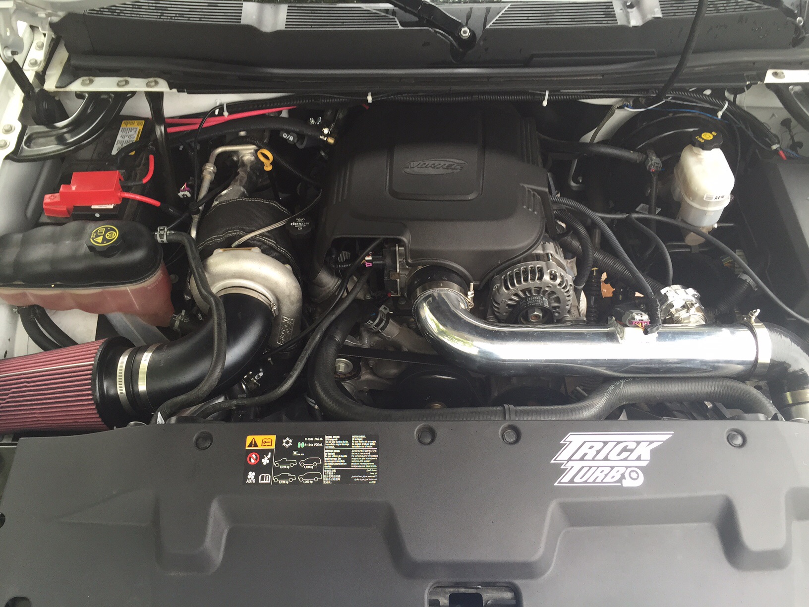

Trick stage 2 kit with upgraded 4" intercooler and precision 74/75.
siemens 60lbs injectors, with flex fuel pump.
XP racing tuned it for 91 octane at 9lbs boost. It made 380/430 at the wheels. The kit installed perfectly. Rick makes it easy. My tuner said I would have made more power if I didn't have the big tires on. I've had a **** eat'n grin all day! Turbo trucks are awesome!

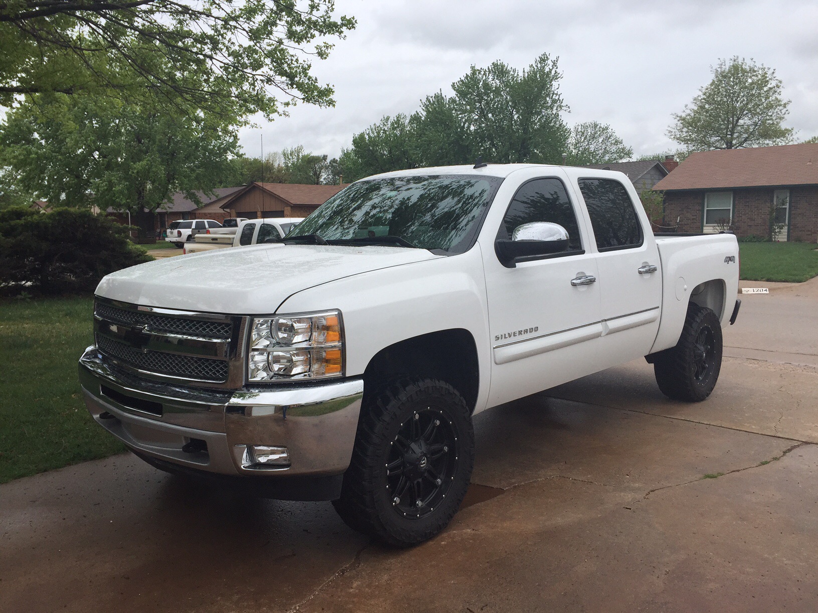

A few more pics

Matt,
I am waiting to receive my stage 2 kit as well. Any particular reason for going with the 74/75 over the 72mm it comes with? I am somewhat worried about pushing 9psi with my 35's. I feel like the 6 speed might **** itself.
Setup looks great!
Doug

Originally Posted by dcs191919
Matt,
Setup looks great!
Doug
As long as you have a good trans tune 9psi isnt much it'll handle it.

I went with the 74/75 so I can continue upgrading other parts and still have room to make more power. Heavier valve springs and methanol are next on the list.
