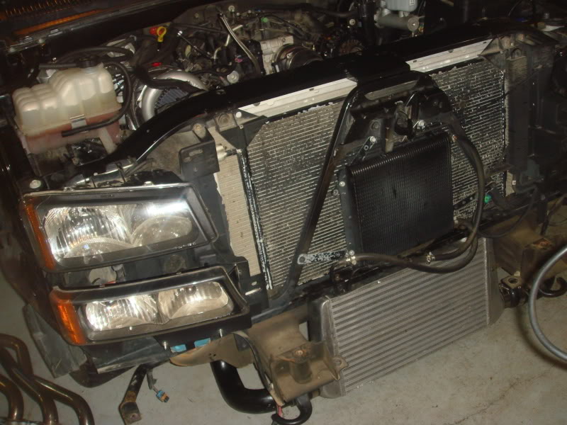

This is how the kb kit was. That intercooler was 27x12x3
I reused a lot of the piping that came with my kit and just cut it and welded it to fit.
Basically its just U bends that go under the core support.
