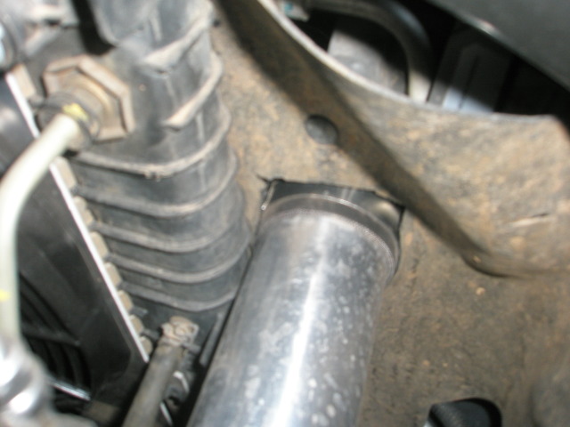

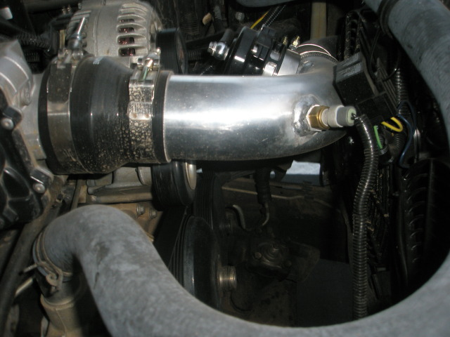

I probably already posted somewhere in this thread but here it is again. I think the IC's dimensions are 31x12.5x3 with 3" tubing from cxracing. With the in/outlets at the top, the easiest routing is to go right beside the radiator (if you still have the factory 28"). Send me a message if you have any other questions about the routing.

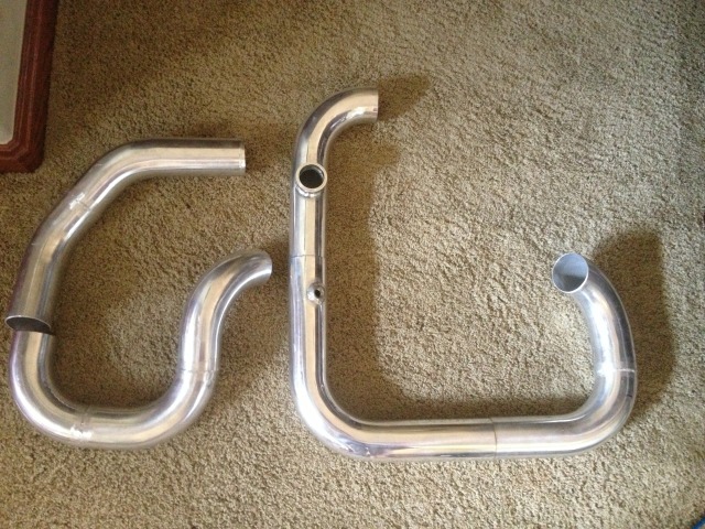

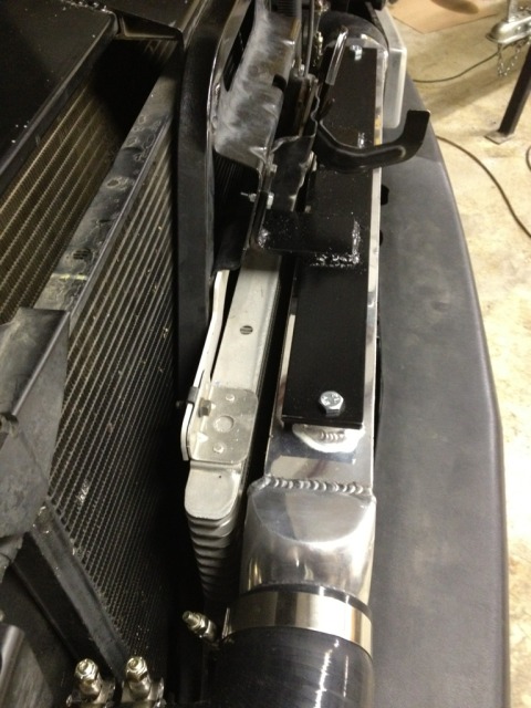

I recently switched to the 34" radiator and had to redo everything. Had to flip the IC with the in/outlets at the bottom. Here are a few pictures if you give af

Are your cold pipes welded together? I was just wondering how the CX pipes were for welding.
Old Aug 13, 2013 | 01:53 PM
  #120
shifty89's Avatar
Joined: Jul 2013
Posts: 140
They weld fine, just keep it clean.
