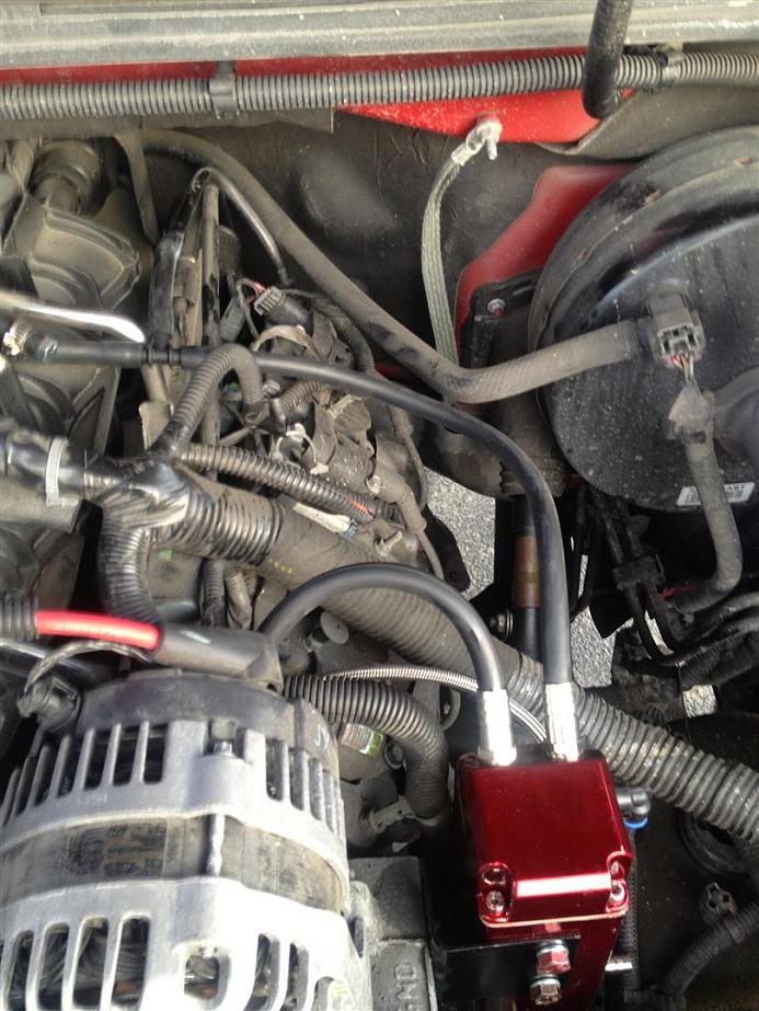

Quick question about the PCV.
I know the right valve cover vent line that used to go into the intake has to be routed to the inlet side of the turbo.
The PCV on top of the intake manifold, can it be left in place?
Is it a good enough check valve?
Or will boost get by?
Both valve covers vented to atmosphere. Or run them to a vented catch can. Then you can run a line from the can to the turbo inlet.

Thanks Blue,
I got a catch can from ebay.
I would assume that now I remove the PCV and plug the opening.
Thanks Blue,
Correct..

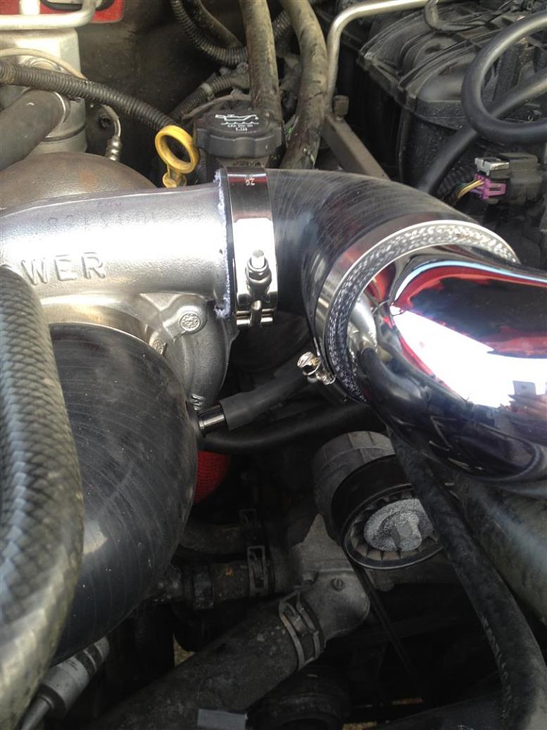

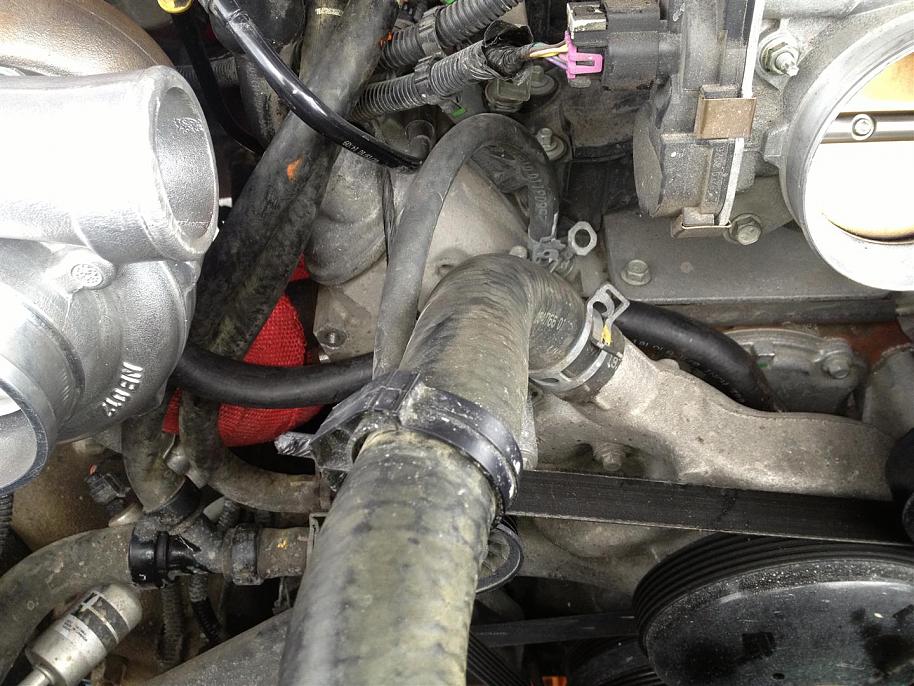

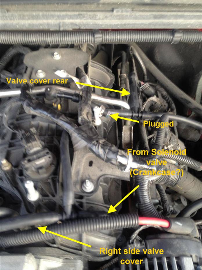

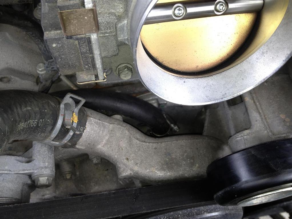

Confirmation and help from the brain trust.....
I routed the BOV to the front of the manifold. Assuming if the throttle body closes, the vacuum will help actuate the BOV.
The right bank vent line used to go into the intake tube, I routed it over the manifold and picked up a line that used to go to the location where I connected the BOV (is this a crankcase vent? It comes up from the back of the left bank), using a tee I then went to the tube that was connected in the center of the manifold, picked it up with another tee and plugged the line to the manifold. From there I went to the catch can. The 3/8 line fit snug into the fittings on the catch can which were for a 5/8 id line.
From the catch can I went to the elbow on the intake after the MAF.
Attached Thumbnails Pics of who's running kb racing turbo kit-img_1436.jpg   Pics of who's running kb racing turbo kit-img_1437.jpg   Pics of who's running kb racing turbo kit-img_1438.jpg   Pics of who's running kb racing turbo kit-img_1439.jpg

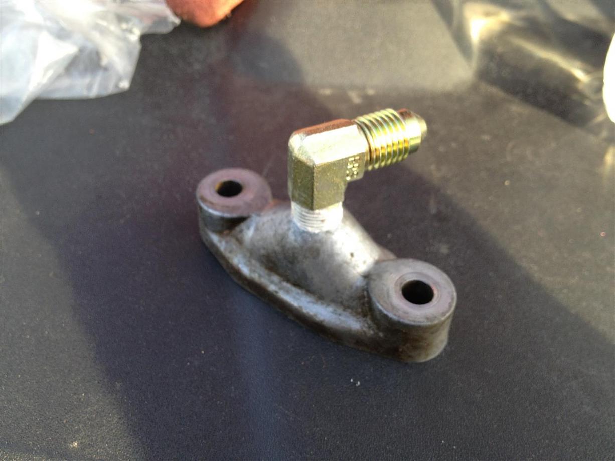

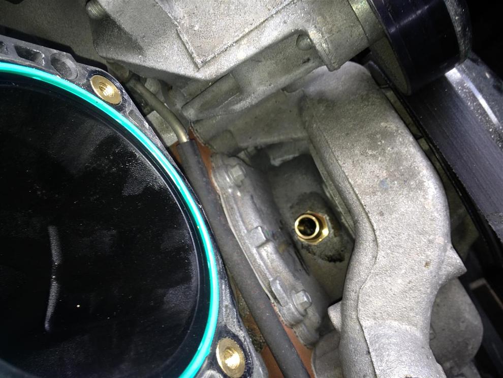

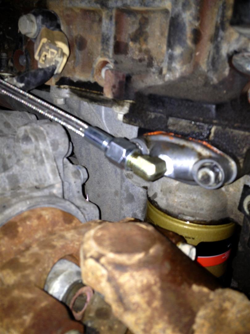

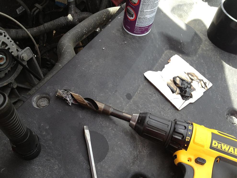

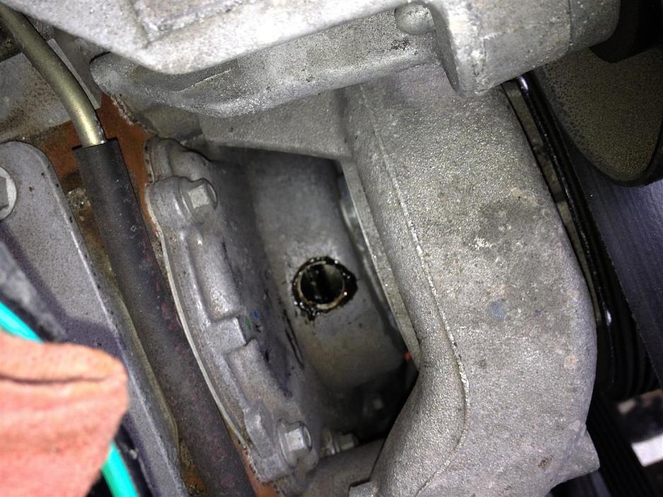

Turbo oil drain connection.
I had a lot of room at the top of the front cover to make a connection.
Being very careful and using a lot of grease while working slowly I managed a hole in the top of the case that I threaded to 1/2" NPT (once again, using a lot of grease).
Attached Thumbnails Pics of who's running kb racing turbo kit-img_1408.jpg   Pics of who's running kb racing turbo kit-img_1413.jpg   Pics of who's running kb racing turbo kit-img_1414.jpg   Pics of who's running kb racing turbo kit-img_1416.jpg   Pics of who's running kb racing turbo kit-img_1417.jpg
Old Apr 8, 2013 | 07:18 AM
  #100
farmallcub's Avatar
Joined: Mar 2013
Posts: 28
From: SW PA
Oil supply right where you said.
Attached Thumbnails Pics of who's running kb racing turbo kit-img_1392.jpg   Pics of who's running kb racing turbo kit-img_1393.jpg   Pics of who's running kb racing turbo kit-img_1395.jpg   Pics of who's running kb racing turbo kit-img_1396.jpg
