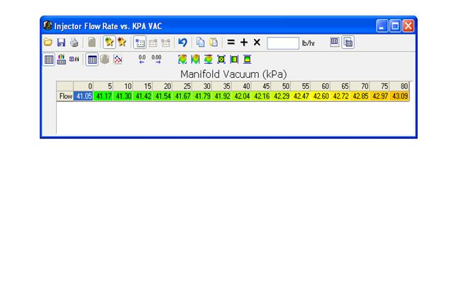

here is my IFR table from HPT. i've been thinking at a MAF based snow kit. would it be worth it to go the meth route? what are the typical gains with it?
