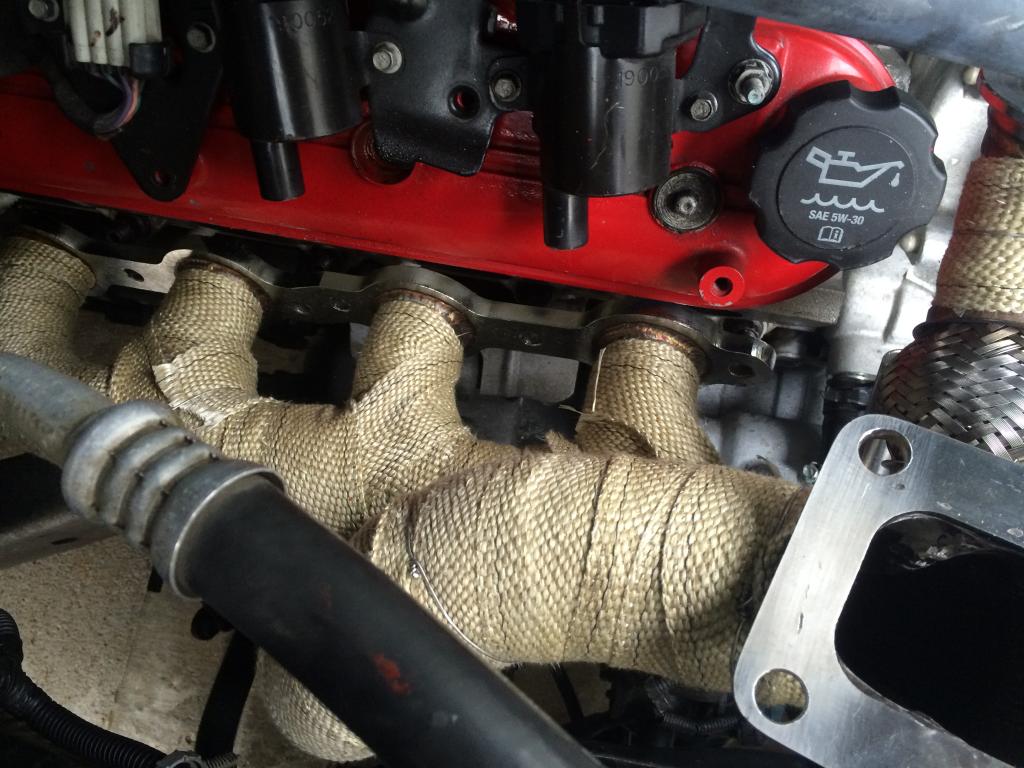

Wrapped up the manifold
Last time staying N/A

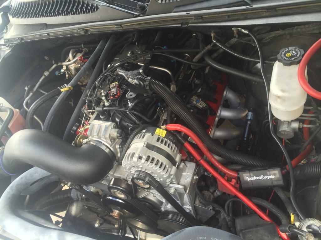

The A/C issue
After removing the Suction discharge hose

Are you sure you couldn't have bent that aluminum tube? I had to bend mine slightly it was no big deal.
