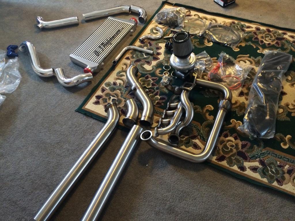

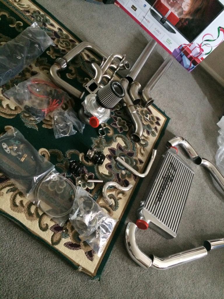

Everything is finally coming along. On3 kit is here and planning on taking advantage of this long weekend to install it.

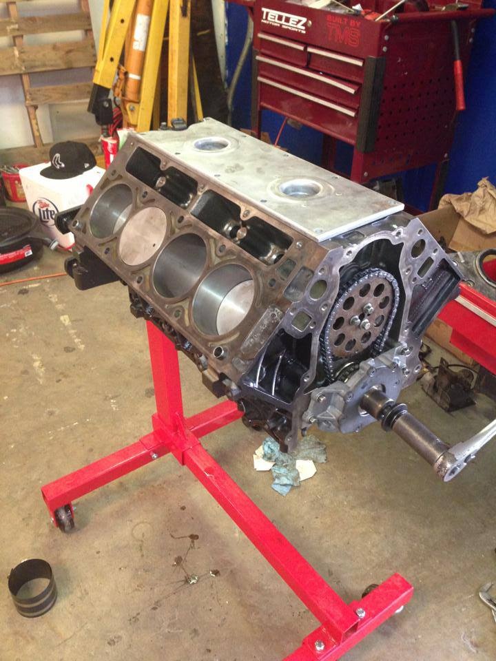

During a cam swap the lq4 had a hurt cam bearing so I pulled it out for a rebuild and used LS2 pistons and rods.. So pretty much an Lq9 now

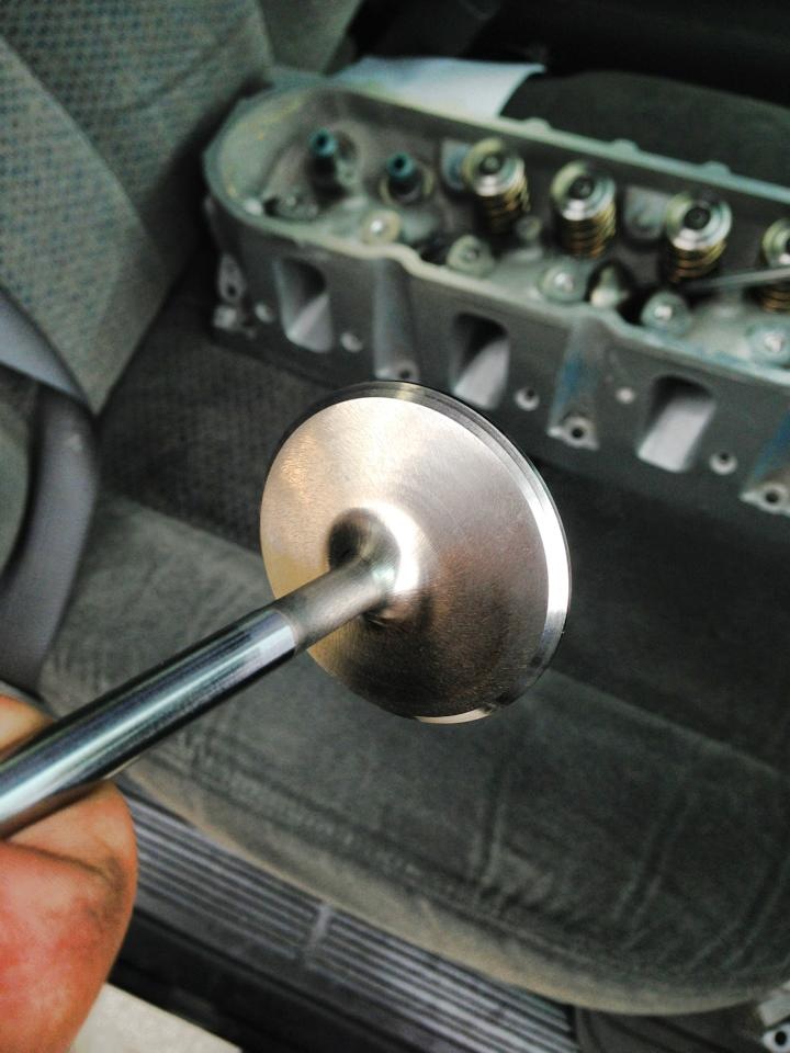

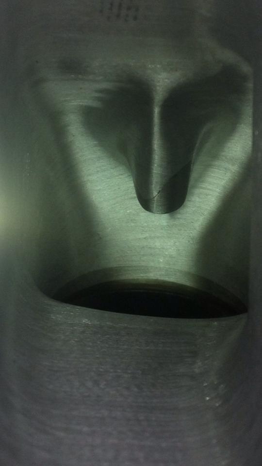

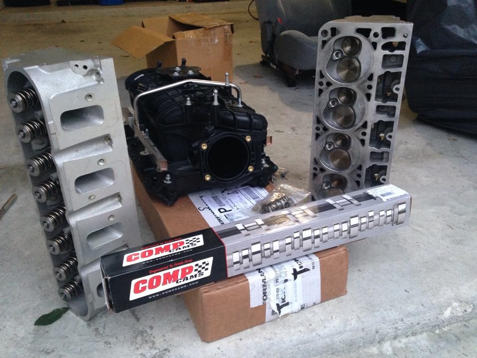

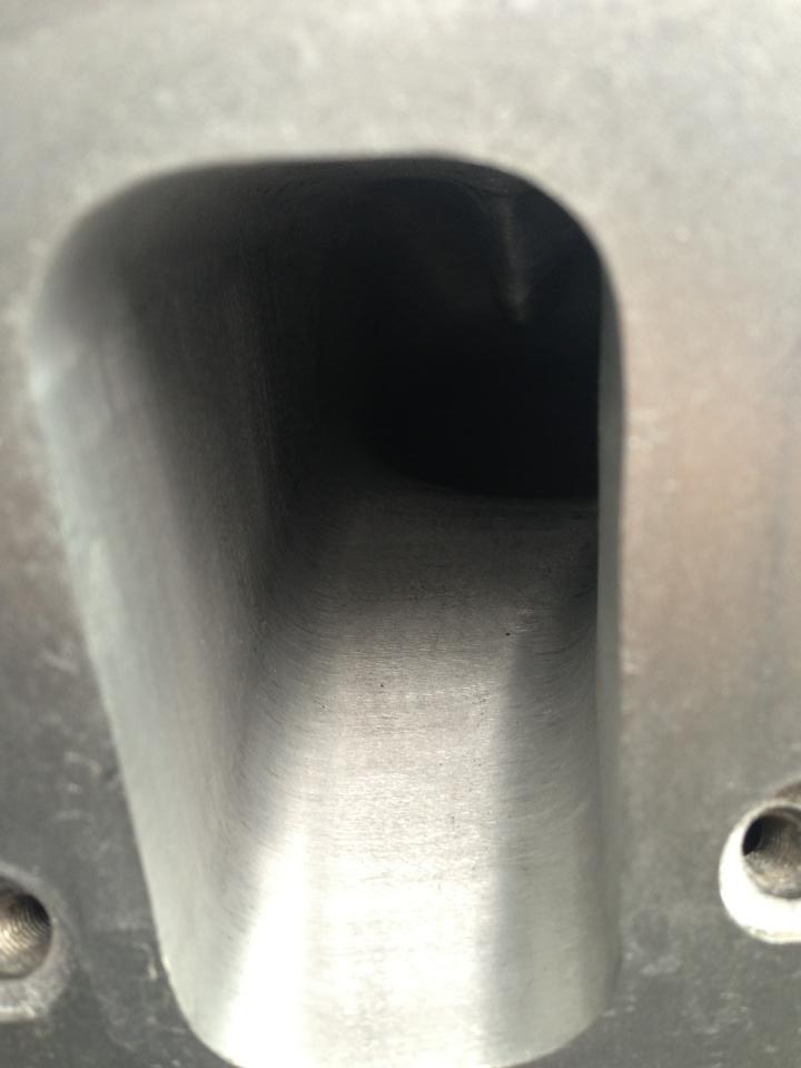

After 4000 miles or so I had a Pac 1218 spring fail on me (228r cam) while idling but luckily there was no major damage done. At that point I got me some LS3/L92 SDPC CNC'd heads w/ Manley valves and .675" double springs hand port finished milled to 66cc, TickPerformance Stage 1 LS3 cam, and L92 intake.

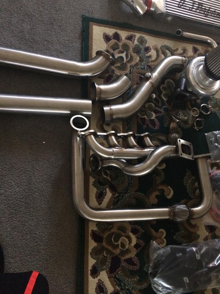

Other than that the original plan was to go nitrous, bought everything for a nitrous set-up and all the goodies for it but ON3's kit was just too tempting so I had to go with it.

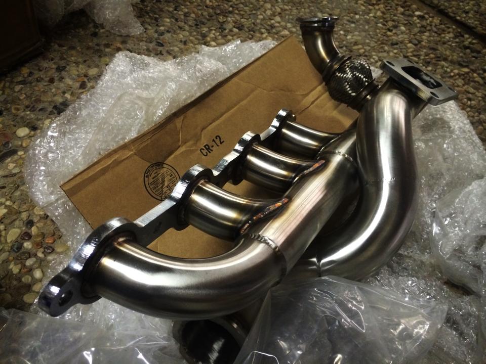

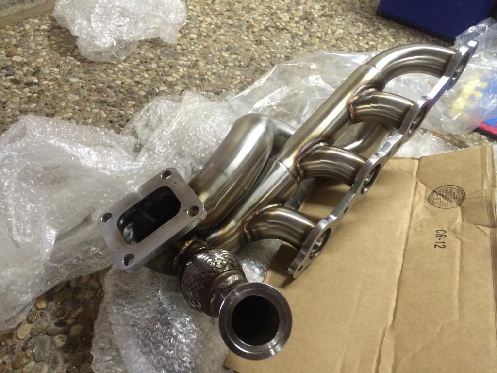

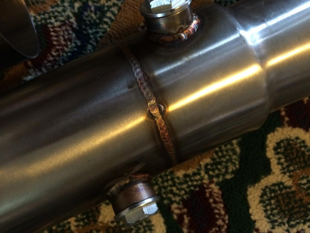

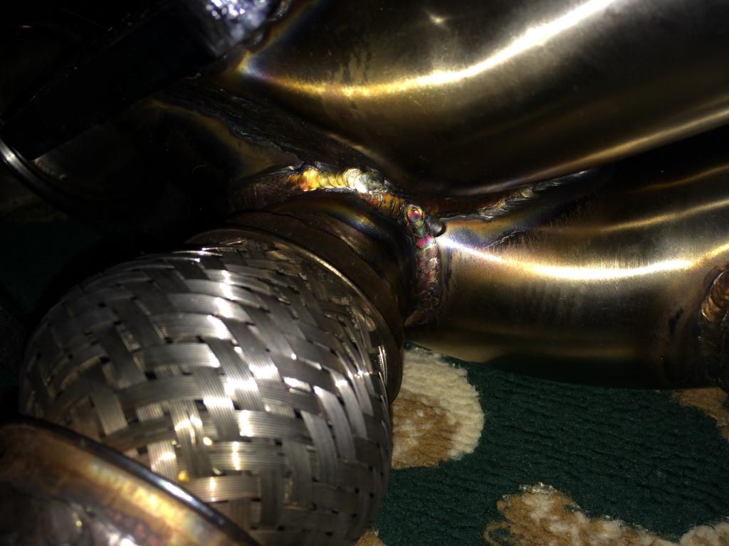

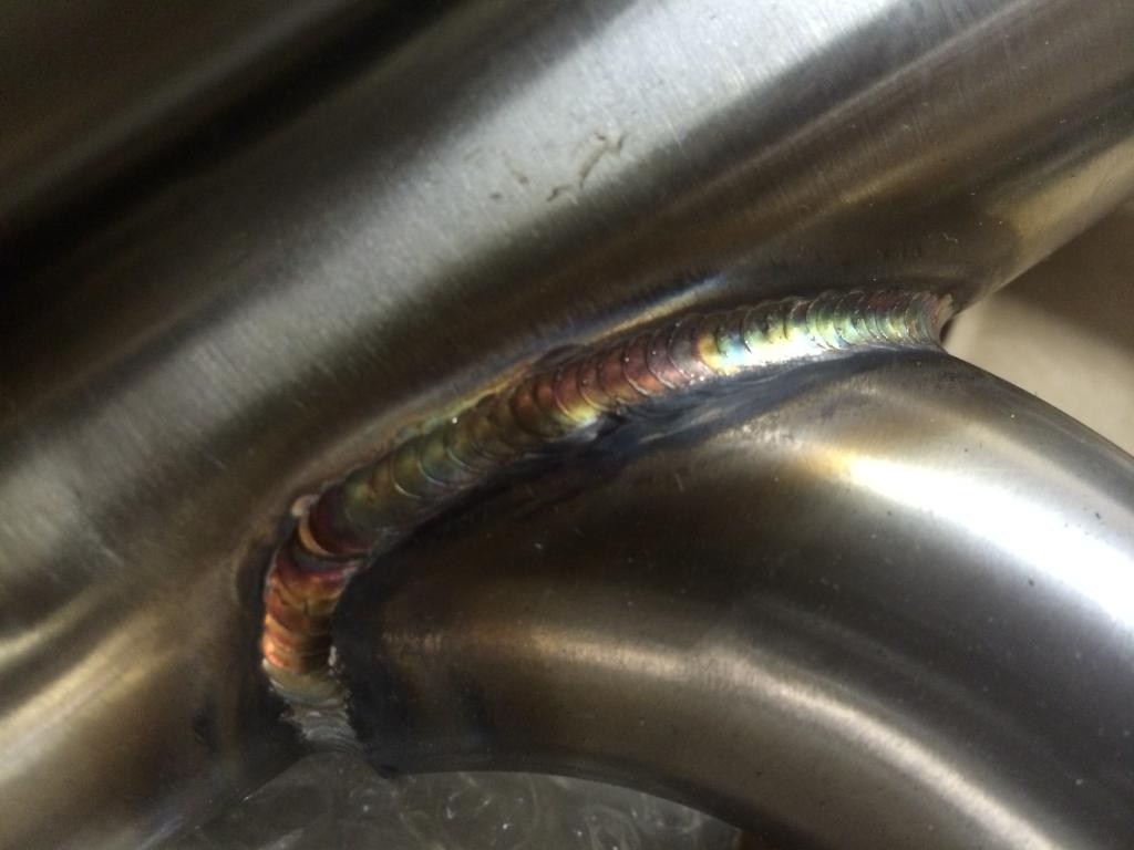

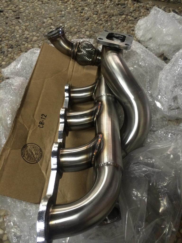

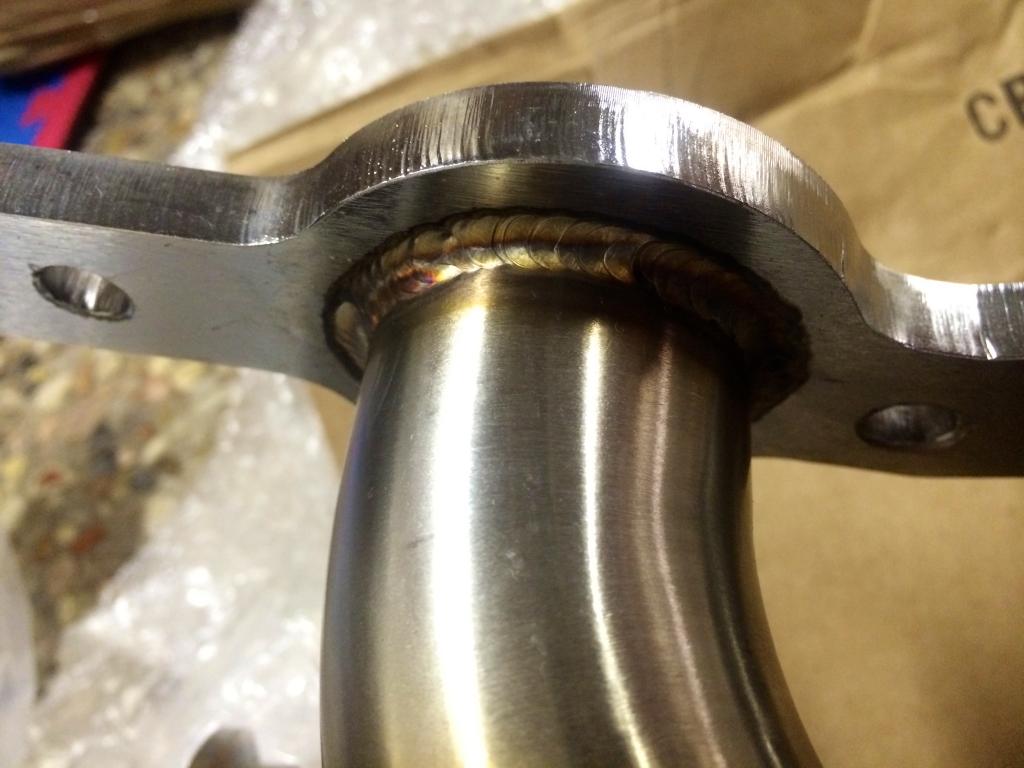

The welds on the Hotside are great! The cold side not the best but still decent since theres only 2 welds total. Everything feels great and good quality.
I'm still waiting on these parts to arrive:
-Yank ProTruck 3200 Multi-disk
-FIC 1000cc injectors
-2 AEM 320lph pumps
-Need to order a Map Sensor
Plans of now is to run it on E85 starting off at 7psi and slowly ramping it up to 10-12psi on their new 78/75 turbo.

That friggen log looks killer!!! I have one of those 78/75's waiting to replace my mp70 but I must get a meth kit first. Cant wait to see it finished!!!
