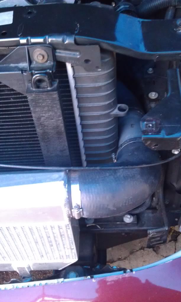

wondering if anyone has any pictures of front mount intercooler set up on nnbs truck with a procharger thanks

Just bought an 08 crew cab with a 5.3 in the process of installing long tube headers off road y pipe and d1sc procharger and the set up I bought did not have the procharger intercooler it came with a front mount 3 core just looking for any information on that kind of set up

I just ordered all new tubing at the beginning of the week so should have it Monday. The intercooler is a universal front mount that the guy had in the same position as the procharger mount. I am going to attempt to put it front mount

That would be my truck, sold the procharger a year ago, let me see if I can find some pics.

Found some, I cut some of the tubing that came with the kit, it didn't had the rolled ends but never had a problem at 12 psi.

How'd you like the procharger in a big truck? What was the setup?
The top end was badass, low end not so good cause I had half the bed filled with sound system. 5.3, eps cam, yank SC3200,built 4L65e and 4.10s. Never went to a 1/4 track with that setup but did a best of 8.4 at the 1/8 mile track.
