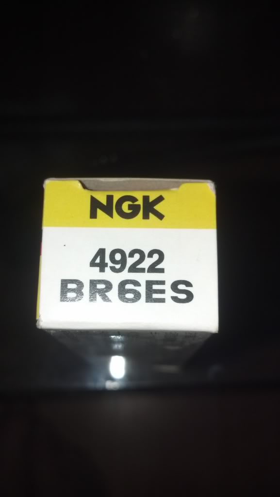

Got my overnight parts from japan in

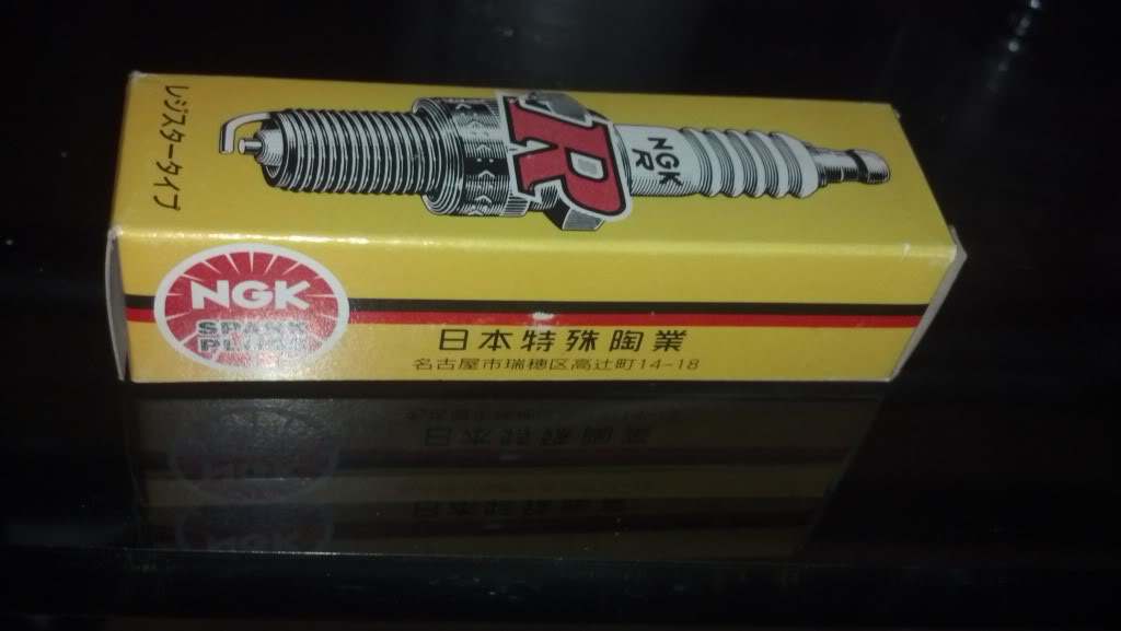

I asked for a NGK br6ef and got this instead. Anyone know the difference? I couldn't find much info on them.
Old Jun 17, 2013 | 07:23 PM
kelsey_canard's Avatar
Joined: Nov 2010
Posts: 959
From: Arkansas
Old Jun 17, 2013 | 07:52 PM
Atomic's Avatar
I have a gauge for that
Posts: 16,282
Likes: 438
Those are the gasket style, you want the tapered style, ie the br6ef (3177). Although those will work if you are in a pinch.

Old Jun 17, 2013 | 11:08 PM
Joined: Nov 2010
Posts: 959
From: Arkansas
Originally Posted by Atomic
Nah go to autozone or orileys and they can probably have them the next day or two at the most.
I live in bfe. Mail arrives on camels I do have an oreilys local. Ill give them a try since you brought it up. I almost think I heard them keeping a tr6 in stock once. Any recommendation on a tr vs br for boost? I know the nitrous guys like the br series.
Old Jun 17, 2013 | 11:18 PM
Atomic's Avatar
Posts: 16,282
Likes: 438
0-8 psi tr6 is fine, 8-15 br7ef, 15+ b8efs
Old Jun 17, 2013 | 11:21 PM
Joined: Nov 2010
Posts: 959
From: Arkansas
Thanks bud. Saved me some time searching. We will see what the brilliant minds at orileys have to offer me tomorrow!
