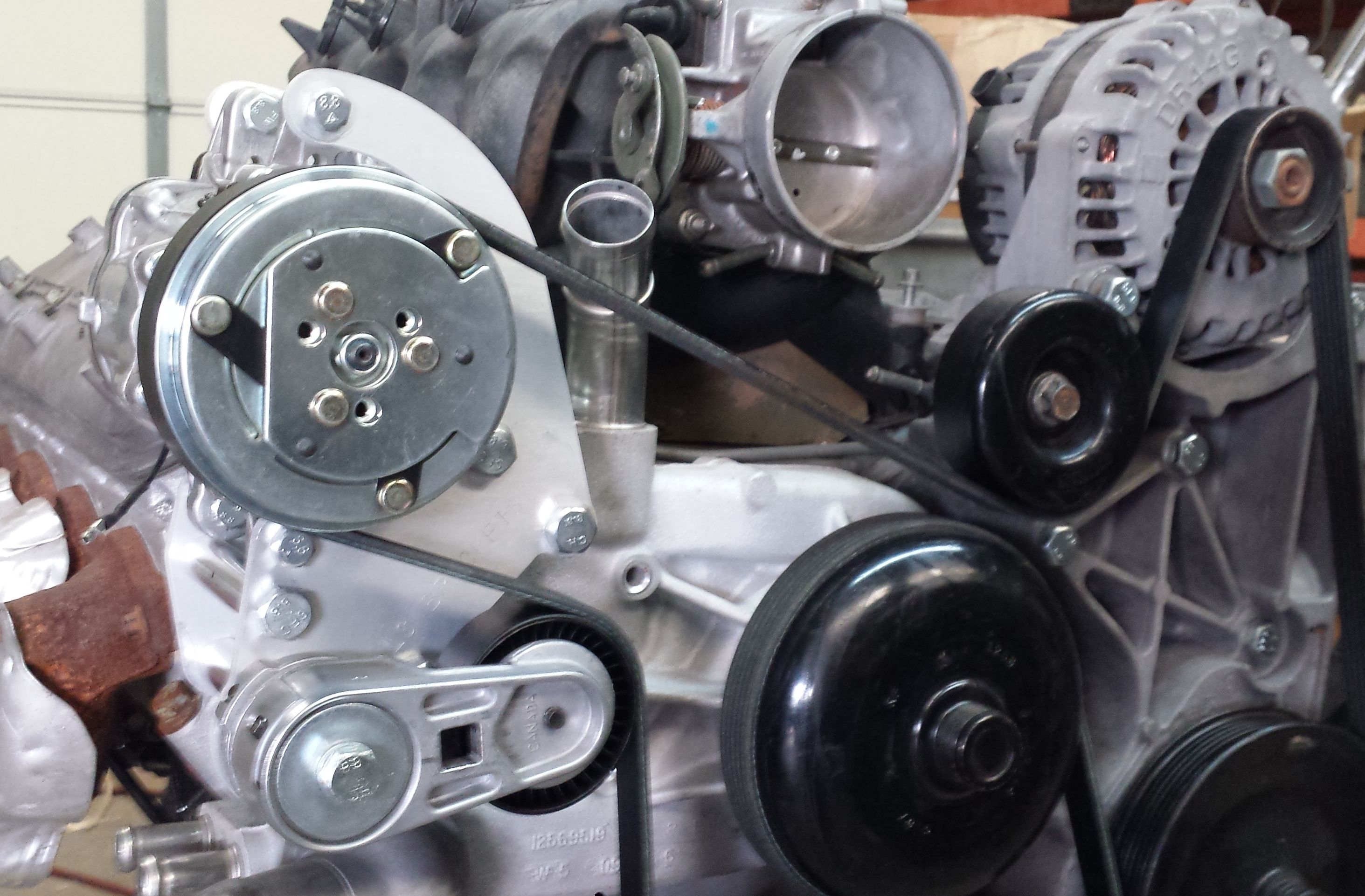

Rick you think this will work with your new manifold. Have to keep them cool and fast.
