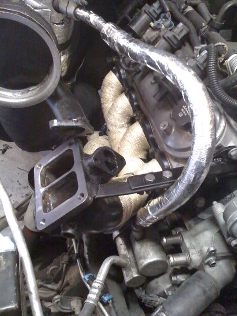

Wow split scroll turbo mani, 5" down pipe.... what are you guys thinking??????
Manifold prototype looks awesome!!!
One thing to keep in mind, I had add a second gate to control boost, my wastewater port was done the same way although yours looks way better!
Old Mar 18, 2015 | 09:33 PM
  #126
TrickTurbo's Avatar
Truck Sponsor
Joined: Sep 2006
Posts: 4,466
Likes: 62
From: Wichita Falls Tx.
Was you gate directly on the manifold? Never had an issue,
And t4 is similar just smaller.
Mine was similar in location, but the divider was much thicker. I was worried about cracking.

Looks like you used a 38mm gate.
Old Mar 18, 2015 | 10:05 PM
  #129
Wilde Racing's Avatar
How do I change this text
iTrader: (26)
Joined: Jan 2005
Posts: 7,294
From: Behind the TIG welder
Yep, good point!
