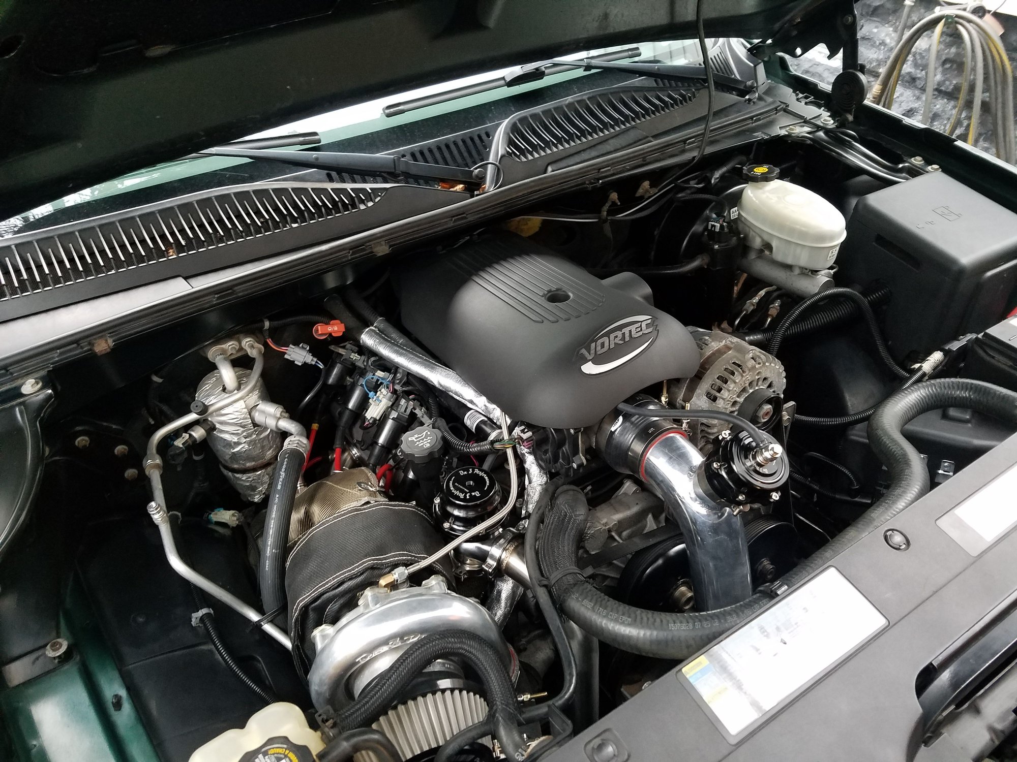

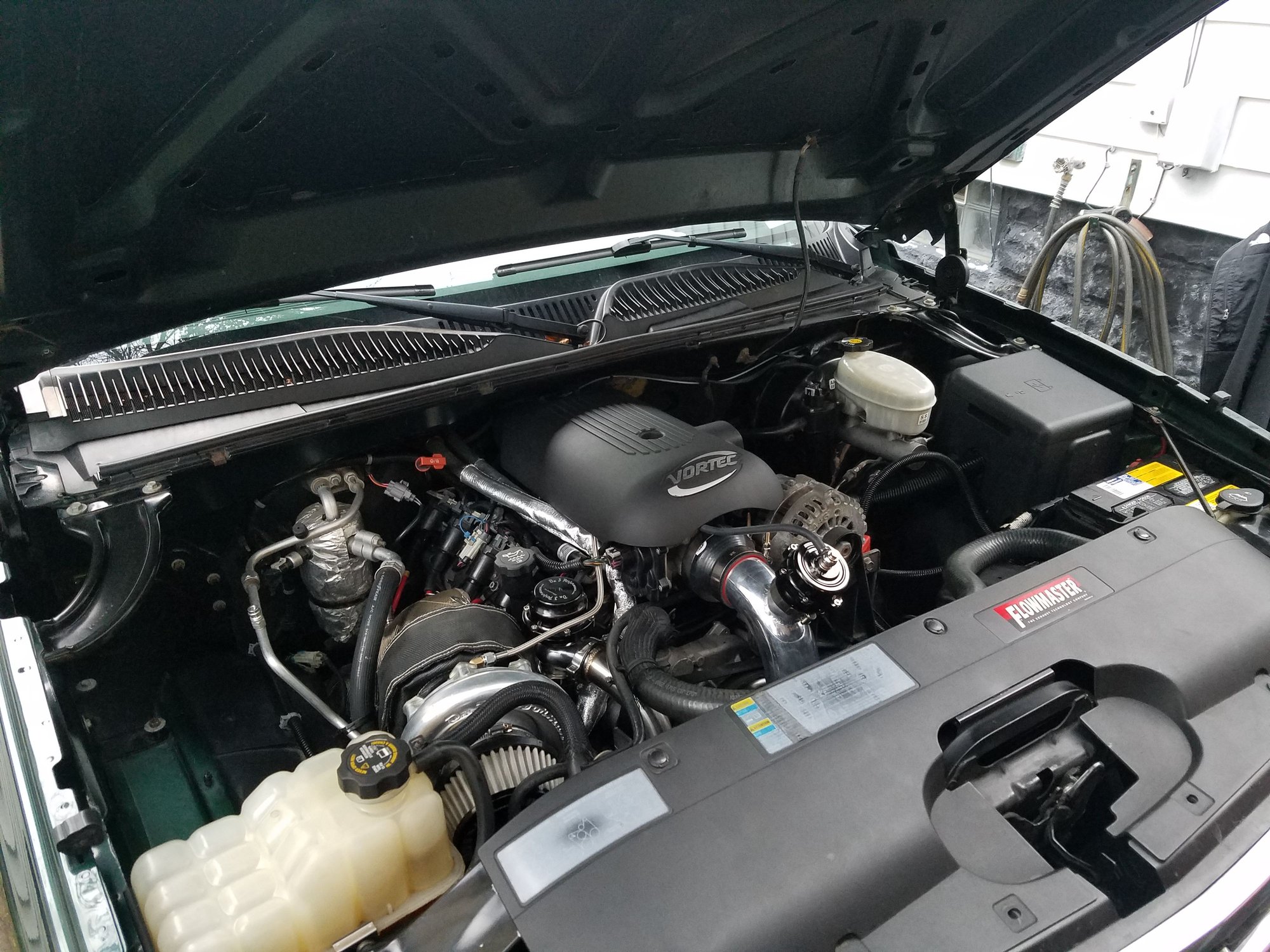

Old Oct 1, 2016 | 08:48 PM

OP... looks like you got it finished! Even managed to keep the coolant tank in the factory location. When test fitting mine, I couldn't see the oem tank fitting.
Did you go SD or hide a MAF somewhere? Any problems with the dump tube on the gate heating up the AC compressor? Seems my tube heads right for the compressor?
The coolant tank is moved forward over the battery tray with new brackets I made. I haven't really seen anyone else go with this exact placement but I thought it fit well and I retained lots of factory lines with minimal trimming.
I was going to stay maf and try to use my k and n air box/maf set up but I put my overflow there lol. And I had to switch to SD anyways because my charge piping had the bung for the iat sensor so I ordered one from ballenger and used a 2bar map. I saw the issue the dump tube I haven't done anything with it yet because the truck isn't even running yet waiting for my tune. I'm a stainless steel tig welder so extending the pipe a Lil further won't be a challenge for me. But if it's heating Urs up looks like I'll have to do it. Not my daily so idk how much of a issue it's going to be for me. Thanks for the heads up
That's a great idea. Never thought about that even. Most everyone seems to use a universal tank and mount it up near the firewall.
You're actually farther ahead than I am at this point. I ended up pulling the kit, putting the longtubes and N2O back on for the rest of the season to get a couple passes in before the track closes for the winter. The wastegate dump tube location just raised a red flag for me. I've got a short list small things like this I'd like to address when the kit goes back on.
