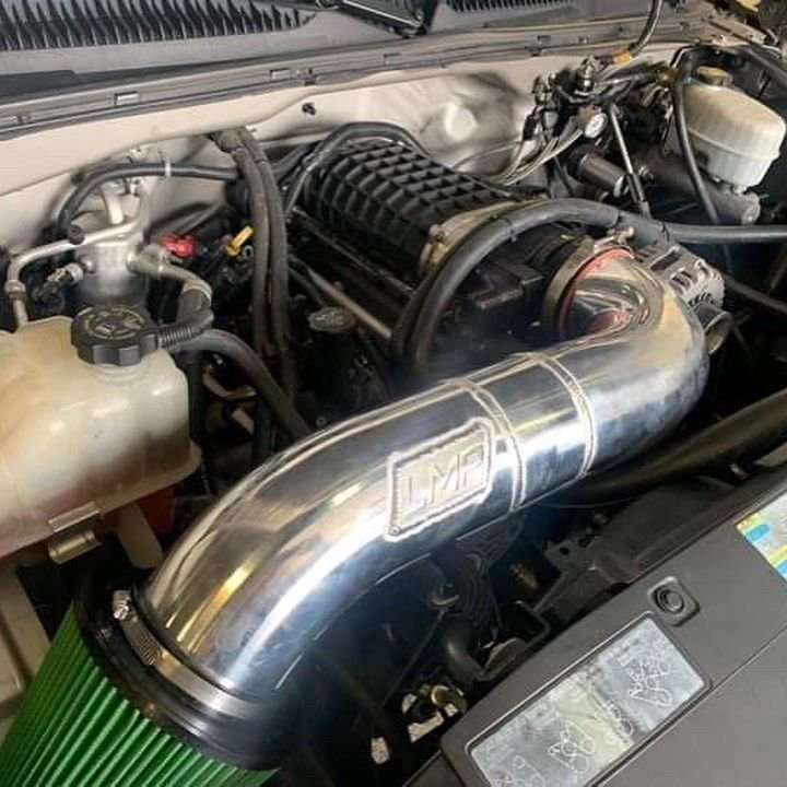

I just want to clarify that the hot rod kit is a bolt on with only square port heads needed. Im running a hd tensioner and a IW 8 rib setup. How did you run the air intake?
intake isn't on yet but will be similar to how I had it on my 2300 in the attached photo. the inlet on the 2650 is angled just a little different so might have to rotate it, or cut a piece off the current intake & angle it up to accommodate for the difference.
