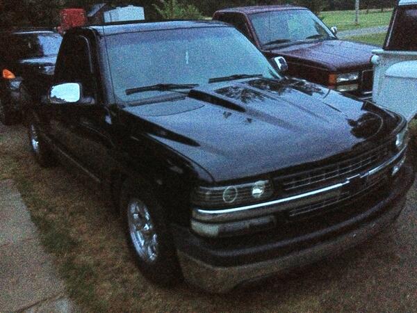

here is my supercharged 2000 chevy Silverado that I just picked up for my freshman year of college and needing some more ideas for more power. it is a 5.3 bored 30 with eagle rods, blower pistons, blower cam, 42lbs injectors cold air intake, whipple supercharger, long tube headers, dual exhaust, stage 4 4l80E tranny with eaton 4.10 posi and its only had half a tune done .

How much power are you making right now and how much do you want?

Nnbs fans and radiator,caltracs and some boggies

im right about 530 and the tuning shop said I could make it to the 600s with the final tune and I don't have a set number I want. I have been thinking about buying caltracs and what are boggies

Dynoed 530 or you were told it made that when you bought it?

530 with 42# injectors?

530rw? I'm thinking that's a motor number, and an estimate. How much boost?

530? How much boost? That's a bit of a stretch with those injectors, any meth injection?
Based on the picture, it's not intercooled and there is no meth, also the blower pulley appears to be fairly large so boost is most likely minimal. I wouldn't bet on that 530 number they gave you.
