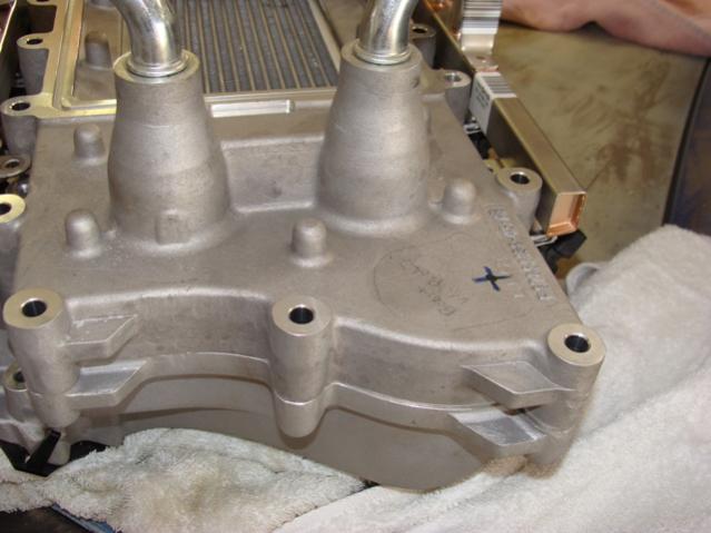

This is where I installed the fitting for the boost gauge.
That looks like a good place to tap off of. Also might to look into something like this.
http://www.full-race.com/catalog/pro...oducts_id=1104
Makes things a lot easier when doing multiple vac take-offs. Tim, don't forget your truck has a return style fuel system. The newer rails included are for returnless systems. You might want to think about aftermarket rails, and regulator.
I'm going to use these, but you, (and I, too) will have to fab some stands. There's not any aftermarket rails for a truck manifold. Just make sure you get rails to match your injectors, meaning the algled or straight up style.
http://www.summitracing.com/parts/SUM-240050/

Originally Posted by TIM Z
Man i didnt think of the rails not working with my return fuel system. ( damn !)
Thanks for the heads up Bill. I will have to cancel my order and look into some aftermarket fuel rails/reg.
Thanks For looking out Bill. Appreciate it.
EDIT, where would the VMV hook up to on those aftermarket fuel rails? is there a provision for it? Im a little in the dark about the whole VMV .
The Vapor management valve vents gas tank vapors into the intake.
It doesn't actually hook up to the fuel rails. It connects to a vacuum port on the side of the supercharger. The nnbs valve mounts on the fuel rail.
I believe the one you have now is actually mounted into the top of the intake manifold, toward the front (thats how my 06 is). I think it would be easier to use the nnbs sytle valve because you can just put a hose on the end of it to connect to the port on the supercharger. The nbs valve has a o-ring end that bolts into the intake and would be harder to adapt. Thats too bad about the fuel rail issue. I didn't have to deal with that as mine is a return-less system.
