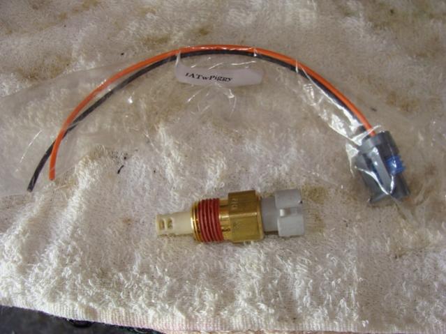

IAT sensor/ pigtail is sourced from what?
I'd like to see where on the manifold you're doin this IAT relocation? What size drill & tap is needed?
I've heard IAT relocation gives a more accurate reading. Just wanted to see what's happening here.
Reference & mount for your MAP pics?
Got ya now Tom,
Yes i will take pics. Not sure what year truck or application the newe IAT sensor will be from, but i will have that info hopefully tonight and will share.Will obviously have to wait to see thread size on the new IAT sensor.

OK, Thanks to 06vortecmaxxx On the lead for the IAT sensor.
Its on diyautotune DOT com . 22.95 with pigtail.
3/8 NPT thread.

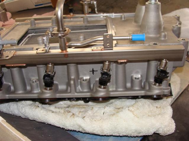

I used this IAT:http://www.diyautotune.com/catalog/g...tail-p-62.html
Used a 3/8 X 18 npt tap. I think the drill size is 9/16.
also when you get the NNBS fuel rails try to get the VMV also, it mount right to the fuel rails. That will make a little easier/cleaner install, instead of trying to adapt the nbs valve. The last pic is for inspiration
Attached Thumbnails My turn to get Blown R TVS1900-feb-2010-169.jpg   My turn to get Blown R TVS1900-feb-2010-167.jpg   My turn to get Blown R TVS1900-april-2010-214.jpg   My turn to get Blown R TVS1900-march-2010-102.jpg
Thanks again Jeff! Really like the " inspiration pic!"
I found a set of NNBS fuel rails complete with injectors off of an 08 yukon. Hopefully it has the VMV hookup your talking about ??
