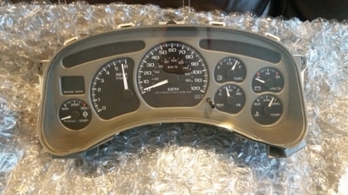

Also, scored this on ebay, I almost couldn't believe it. Been a member on there for almost 15 years and finally got someone at a deal. $75 in mint condition. 86k miles on odo. I got this for 2 reasons. 1, 120 speedo will be very useful at the track 2. I'm going to put a boost gauge on the A-pillar because at the track I have no clue how much boost I'm building at the line. Was guessing based on sound - obviously that wasn't accurate.

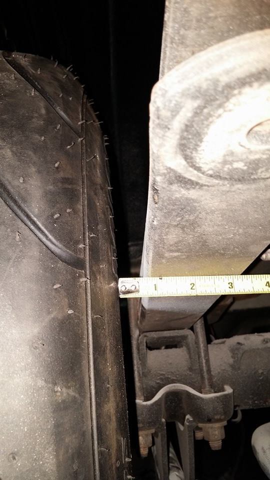

FYI i have 3/4" clearance with 15x11 with 7" BS with 315s

Seems to be differences related to the 14 bolt vs 10 bolt
FYI, I had the 315 DRs tucking in the rear with flip kit.

must be cause if i would of known this i would of went 7.5" BS
i know my wheels measure more then 11" from outside edge of bead lock to wheel lip its 11.5

To be honest, you've got a nice safe margin to the leaf spring there. The real issue is that the 315s a bit too wide for the stock fender well even with pulled out fenders and stock leafs.
I truly feel to do these tires real justice you need 14" wide wheels and double beadlocks.

i agree with the 14" with beadlocks, we have them on a set of 15x12 bogarts on blue beast and they are just a hair more square on that wheel

If you have time to watch the speedo at the track you arent going fast enough
