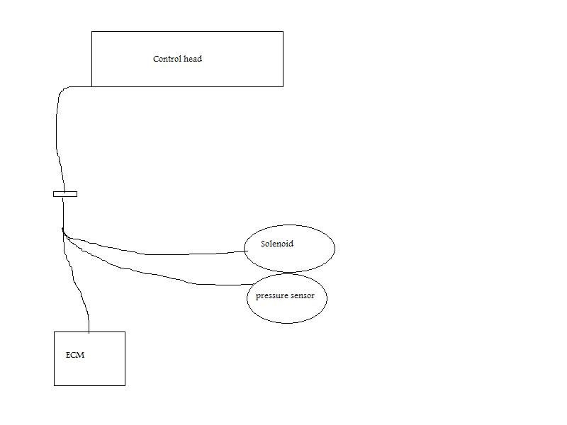

I got my boost controller today. There is a lot of Chinese writing in the installation manual and what not but I think its going to work out fine. Its just six wires, power, two grounds, TPS, RPM, and VSS. My concern on the harness length turns out not to be an issue. The control head has about a 4 foot lead on it with a connector. That should be more than enough to get over to the A pillar and about halfway down it where I can plug in the lower end of the harness and secure it to the cab behind the pillar plastic. About a foot after the connector the harness breaks out into three leads. One is the 6 wires that get tied into the PCM harness, one goes to the boost pressure sensor and one goes to the solenoid. The lower section of the harness has to be another 6-8 feet long. So far I'm impressed with the unit but it will be a while before I get to put it to use.
