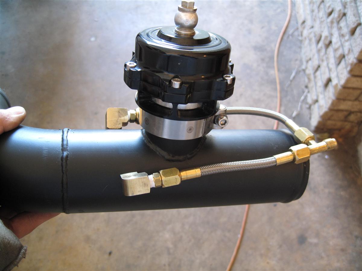

Actually you want it 100% vaporized, but you want it to be 100% right when it reaches the intake, not any sooner. If its sooner it will be heated up by the intake tube. You want the coldest temperature when it reaches the cylinder.
heres where I put mine. Where im holding it is where it goes into the tb.

nozzle will be 12" away from tb and iat sensor is 6" away.
my cold pipe from my intercooler is goin to be very very short, 8" or so.
how did you manage that?
