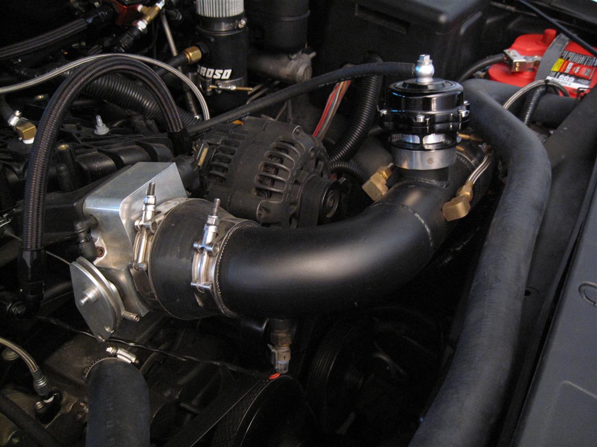

heres where I put mine. Where im holding it is where it goes into the tb.
man that sure is purdy!!
what size nozzles did you ende up using?

Its an M10 and M15

Yea, I told Julio 1000hp and he recommended dual nozzles....I havent even used the meth yet.

I mounted mine just like Atomic, but I only have one nozzle, maybe I should upgrade, 2 look way cooler, lol.

Its an M10 and M15
thats a lot of meth. i'm going w/ the stainless lines too, don't trust the plastic ****. single 14 nozzle should be all i need tho.

Originally Posted by Atomic
Actually you want it 100% vaporized, but you want it to be 100% right when it reaches the intake, not any sooner. If its sooner it will be heated up by the intake tube. You want the coldest temperature when it reaches the cylinder.
See, this stuff sparks a ton of debate It honestly depends on where you want the heat pulled out. For me, I don't want all the heat absorbing ability of the methanol completely diminished before it enters the cylinder. Really depends on how you want to use it, though.

Well, you want the highest temp you can get after the ignition event to produce the highest cylinder pressure. If its before, then you get pre-ignition. If not all of it is vaporized when ignition starts then some of that energy is going into vaporizing the methanol lowering the total sensible enthalpy, which is not harmful, its just inefficient.
Heres another pic.
