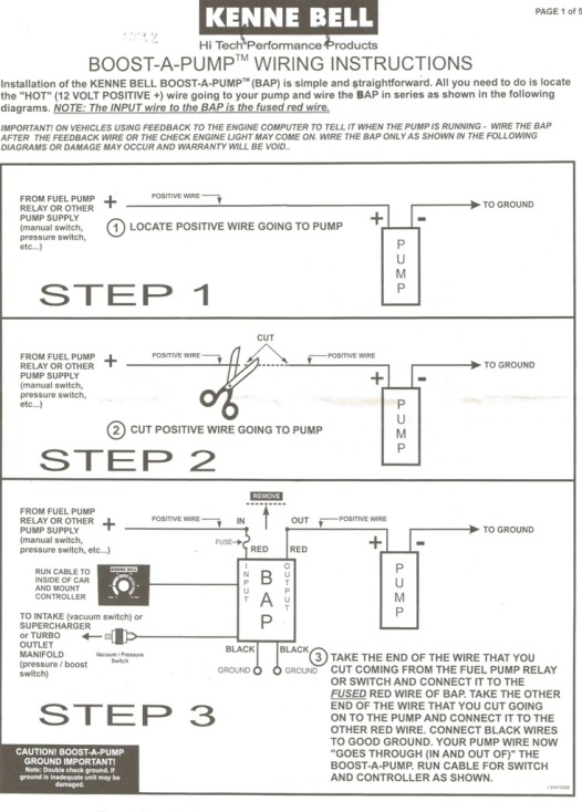

The way it sounds like you've got it hooked up now, current flows backwards through the main fuel pump circuit when the Hobbs switch comes on.
^^ This.....
If Im reading this correct, the extra voltage from the BAP would be backfeeding into the FPCM. Im not saying it wont work, I just dont see how it is working with the FPCM and not freaking out the BCM.

Originally Posted by carbongmc
^^ This.....
He doesn't have an FPCM, but same idea... It may never hurt anything but knowing that's happening while in boost makes me wince lol. If anything, I'd be worried about the current draw through your BAP and the potential for it to kick the bucket mid pull and cause trouble...

Here's the diagram

So it is hooked up in series. The way you worded it, it sounded like it was in parallel.
