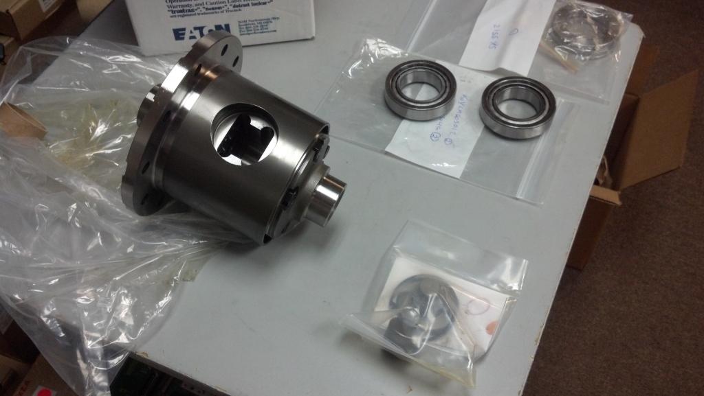

well before i do these springs i gotta put this baby in. out goes the g80 in goes the trutrac

wise choice
