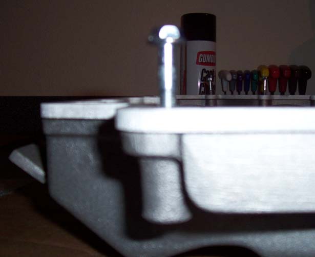

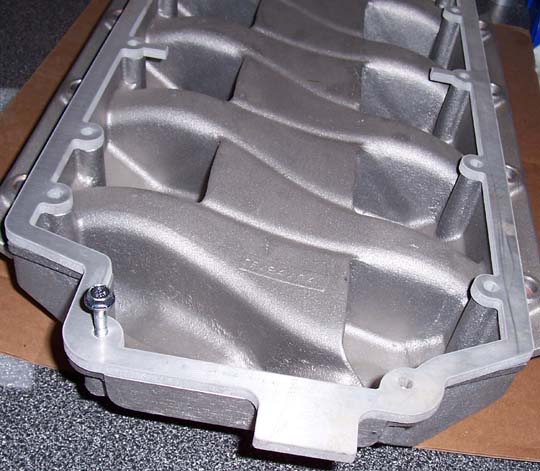

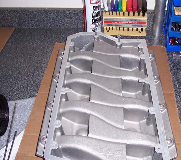

pics.!!!!!
Attached Thumbnails Magnacharger/nitrous-100_1393.jpg   Magnacharger/nitrous-100_1392.jpg   Magnacharger/nitrous-100_1391.jpg   Magnacharger/nitrous-100_1394.jpg

Originally Posted by moregrip
not sure I follow, whats the plan?
The blower unit will need to raise 1/4 of an inch plus lets say .035 for a gasket.( gasket still needs to be cut). This will raise your fuel rails up that same distance. If using the stock injectors stock mount tabs on your fuel rails need to be removed. Now if you are using aftermarket injectors (exp. bosch) that may raise your rail enough to get the job done as in no cutting your stock rails mounts off.
Working on the replacements brackets to allow you to install this set up with your delphi injectors. if you want to sale the plate to in the future, no problem, there will also be another set of brackets so you can return to stock if you want.
parts list as I see right now.
new bolts
1 gasket
1 plate
jets
2 set of brackets.
and the rest of a nitrous kit, noids, lines, brackets, etc.
Ok there will be spray bars installed into this plate. The fittings will be in the front. You will be able to spray nitrous/fuel, nitrous/meth, water/meth or water ever media you would like to add the cooling and hp level of your choosing.
Now I only the nitrous side of things. I know -127 boil rate will cooling any charge down, and and extra amount of fuel, will give the hp level anyone may want to go to. The lowest HP setting I have so far is 50hp,,, the most is 300hp. If your temp sensor is in the manifold, you will see a change thats for sure. here is a VERY VERY rough lay out on what is happening.
Ricky
