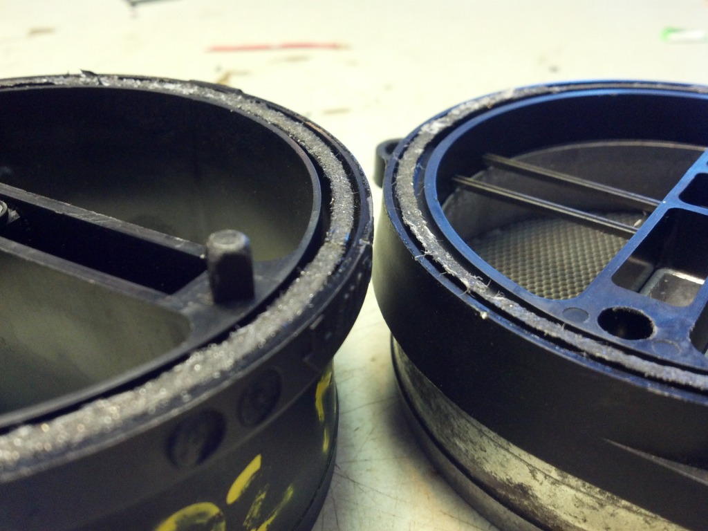

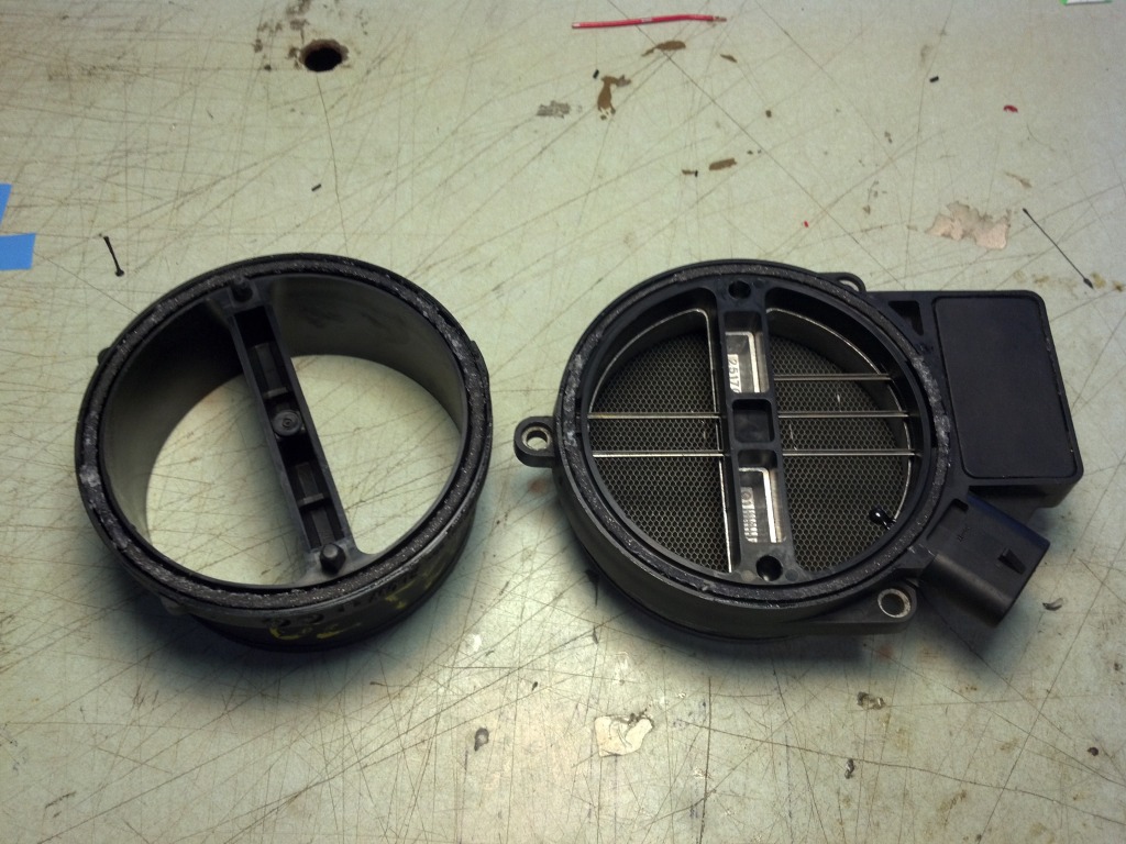

Couple pics. It was a clean break. Looks like it is maybe glued at the joint from the factory. I superglued it back together and it will probably be even stronger now, or it will break somewhere else.

It's happens. If the maf is under any tension it breaks pretty easy.
