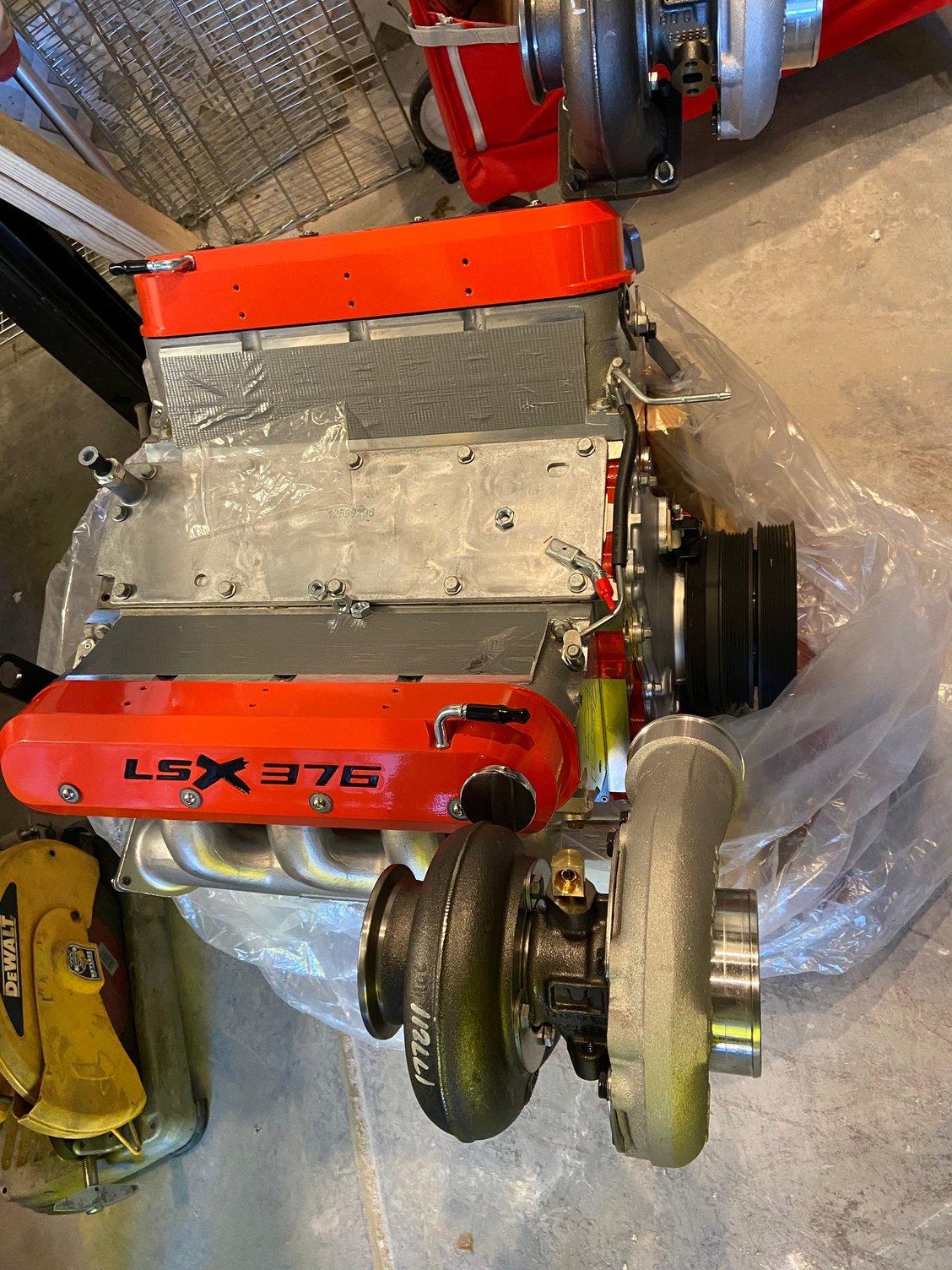

Originally Posted by dantheman1540
I wonder if that stock cam would be worth something selling it.
Got any pictures of this sucker? Those crate motors are always pleasing to the eye.
here’s a couple of pictures.
