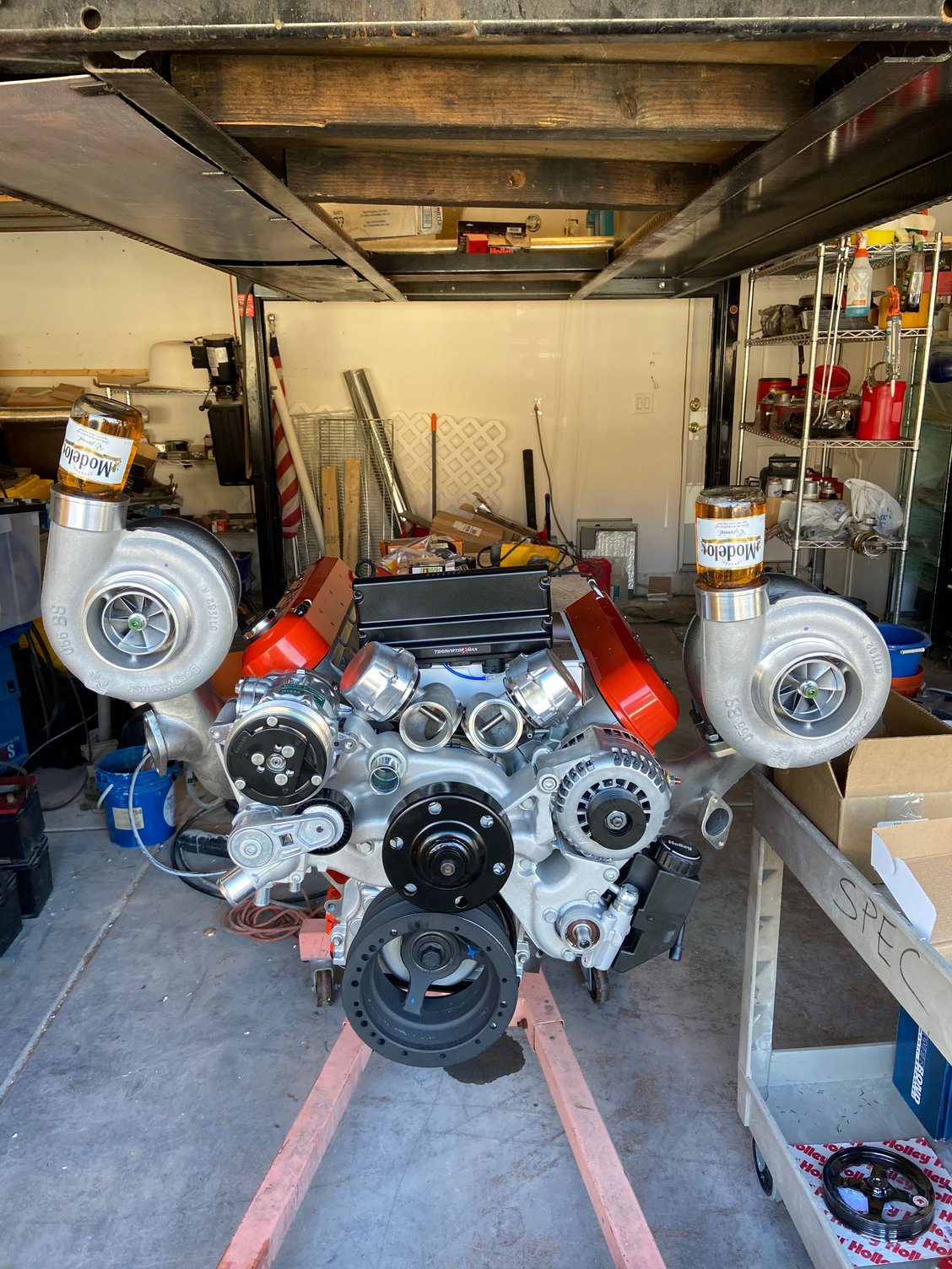

What size did you end up with?
Old Feb 20, 2020 | 08:10 PM
  #52
wretched73's Avatar
Joined: Jul 2010
Posts: 1,273
Likes: 450
Looks real sharp, also curious what turbos those are
Old Feb 20, 2020 | 09:08 PM
  #53
stacy moore's Avatar
Joined: May 2012
Posts: 146
BW366s
S300SX3 Turbocharger
  • 66mm / 2.60'' Compressor Inducer Dia.
  • 3.60'' Compressor Wheel O.D.
  • 73mm / 2.89'' Turbine Exducer Dia.
  • 80mm / 3.14'' Turbine Wheel O.D.
  • 0.88 Turbine A/R
  • T4 Open Flow Turbine Inlet
  • Straight Compressor Outlet

That looks awesome! I see you went with trick manifolds I feel that was a really good choice!

Gotta say that is pure sex!

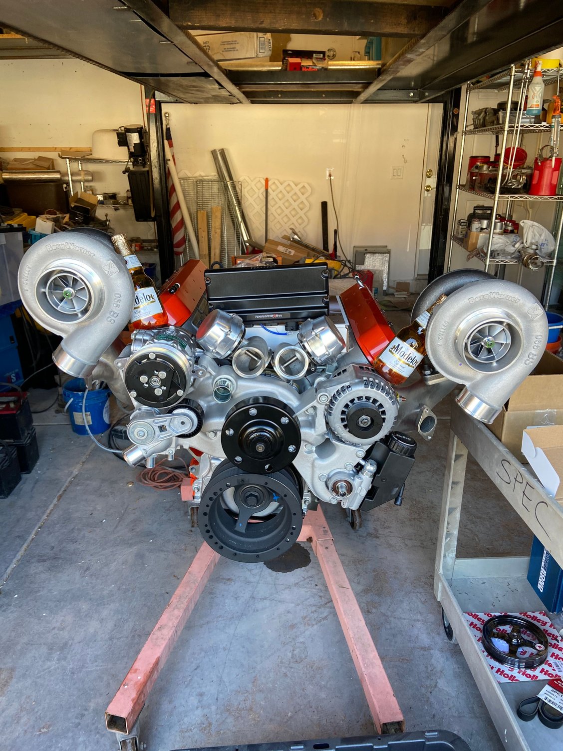

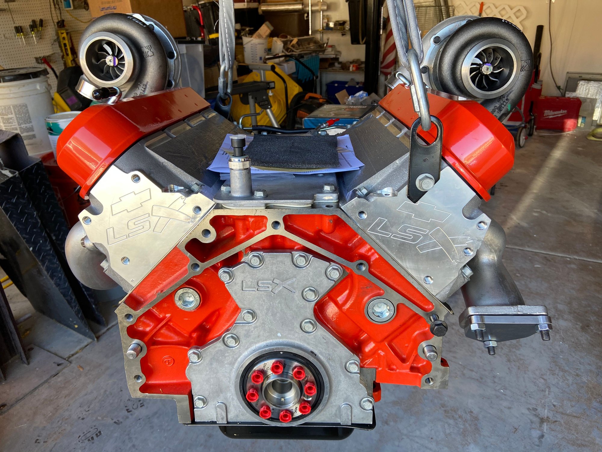

Got a little work in with the nephew today!

That balancer is quite interesting. Did that come with the motor or did you install it? It looks like an LSA balancer

It cam on the motor, but I bought the Holley Mid Mount that comes with a harmonic balancer but not installed yet.
this is from the installation manual;Accessory Drive
The LSX long block engines come with a crankshaft harmonic balancer (dampener) which is designed to align with a 2009 production rear wheel drive car accessory drive systems. GM Performance Parts (GMPP) offers several front end drive kits with alternator, steering pump and air conditioning. Please refer to the GMPP web site for specific part numbers and applications.
