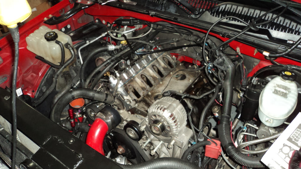

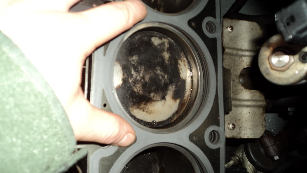

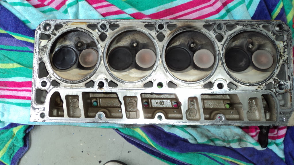

The day has come, work a little to play a little. During the install of the PTE76GTS, I noticed some coolant around the heads/block, both sides, like a tear drop from a 4.8L who's been gettin beat on . A few nights priors to the swap, I was really cranking the MP70 for her last days. I included a HPtuners log showing one of the many 1st-4th gear pull with boost mostly 17-18psi area and on the 3/4 shift it spiked 19.9PSI. This was on Stock Gaskets/Head studs, so I figure they put a hell of a fight for nearly 90k miles of many many many pulls being at or above 15psi.
I drained the oil and seemed normal and the over flow was only slightly low.

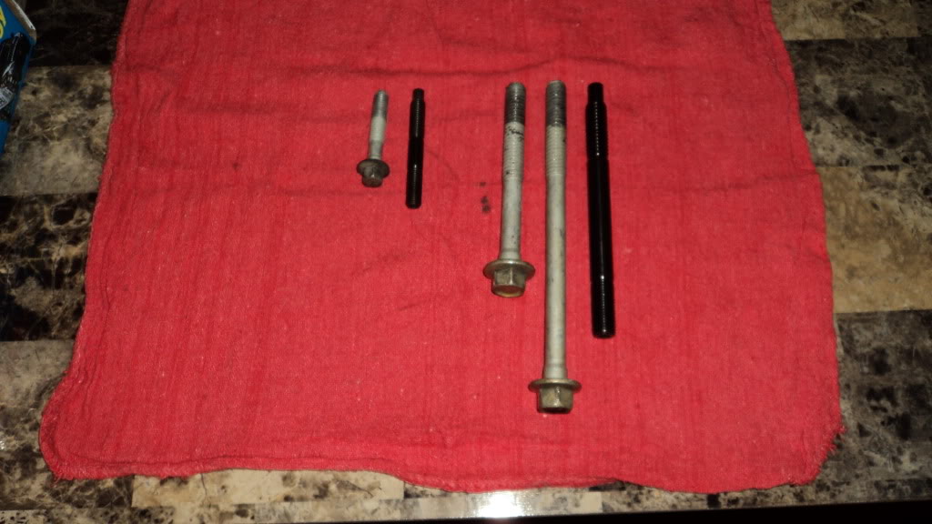

So, that was my plan for the weekend when my blood alcohol level was normal again. All was going good till I went to re-install the drivers side head. I have an 04 truck so I ordered ARP 234-4317, 04+ and newer studs. WRONG. I have 3 sizes of studs, checked the build date and my truck is a 12/03. So I have a 04, built in 03... Ok Corrert kit is ARP 234-4316 (99-03)
So truck will be down next week till I get some studs in and head back on. Really hope she seals up nice and I can get back to the track!!! Wish me luck guys and check those damn build dates before ordering studs!
