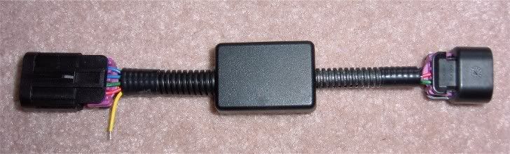

Just a pic of my prototype package.
Old Feb 25, 2007 | 12:47 PM
  #23
TurboGibbs's Avatar
Joined: Jul 2005
Posts: 5,257
From: Decatur, AL
Very cool man. I'm extremely interested in this.
Old Feb 25, 2007 | 01:23 PM
  #24
moregrip's Avatar
what a rush!
Joined: Feb 2004
Posts: 17,629
Likes: 33
From: Wyoming
looks clean
Count me in!!

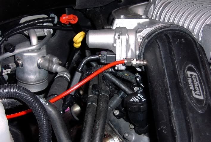

One more pic:
Old Feb 25, 2007 | 09:08 PM
  #29
LBSBLOWN's Avatar
Joined: May 2003
Posts: 339
From: Keller, TX
Kool, I'm very interested too.
Is the black box going to be water proof?
the reason I ask is that I'm having problems with my Magna volt if I
wash down my engine it fails to work again and has to be replaced.
so I have to take special care with it (MagnaVolt) when washing the engine.
Old Feb 25, 2007 | 09:56 PM
  #30
DrX's Avatar
DrX
Joined: Jun 2005
Posts: 2,703
Likes: 6
From: Canada
The electronics will be encapsulated. But from prior experience, you still have to be careful not to get the TB connectors wet. Even though they have seals. Moisture entry can trigger REP mode. Usually resolved by blowing out the connectors with compressed air.
