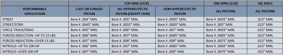

You can clearly see the motor went south because of the ring gap. It pinched the top ring land and broke the top of the piston. You confirmed this fact when you stated the top ring was only .017
The top ring gap should have been significantly larger for up to 15 Lbs of boost. If you follow the chart below, 4in. X 0.006 =.024 for the top ring.
Now, with out seeing the rest or knowing exactly which parts were used, It's hard to say what other issues you may have had.

Thanks for your comment. This is the type of stuff I need. When I first posted I didn’t have the pistons and rods pulled. I didn’t do this build, and would nevvvvvvverrrr have put any less than .024 for the top ring. For the replacement build, I’m considering .030 because I want to run 20-25 psi (or whatever it takes for 10.99) and considering a 25 shot to spool up for roll racing so I don’t have to kill the already inadequate 13” rotors with brake boosting. I believe most gaskets were Felpro.

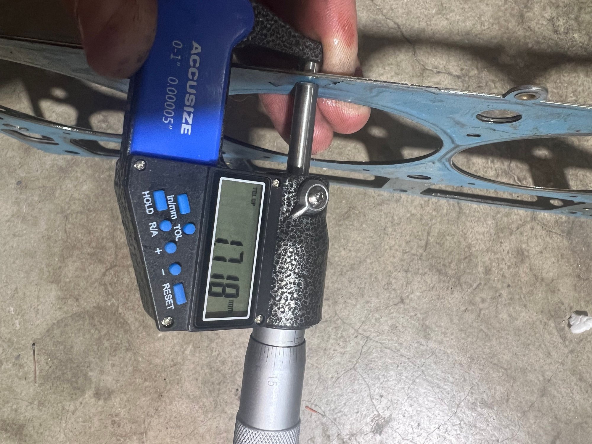

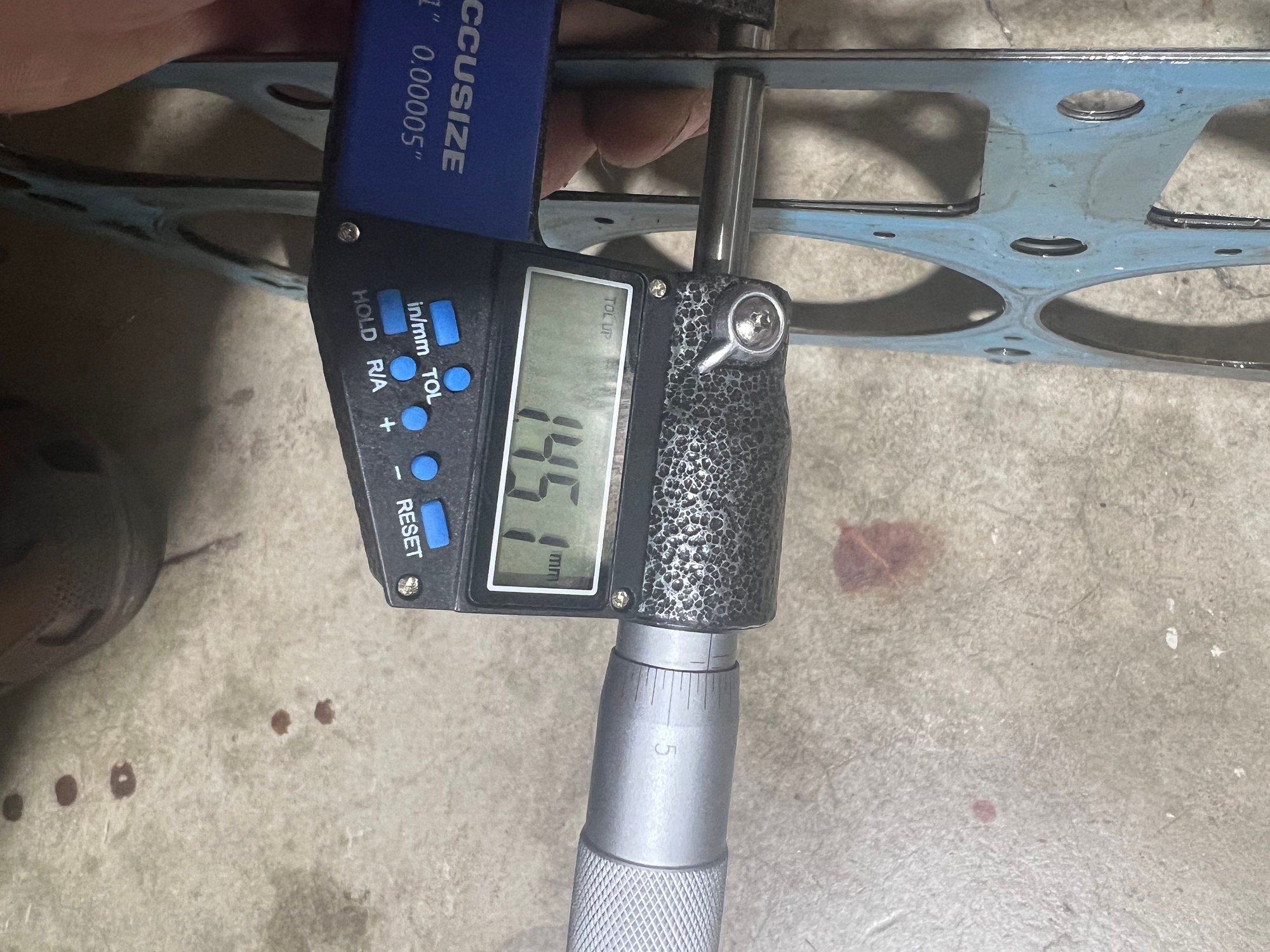

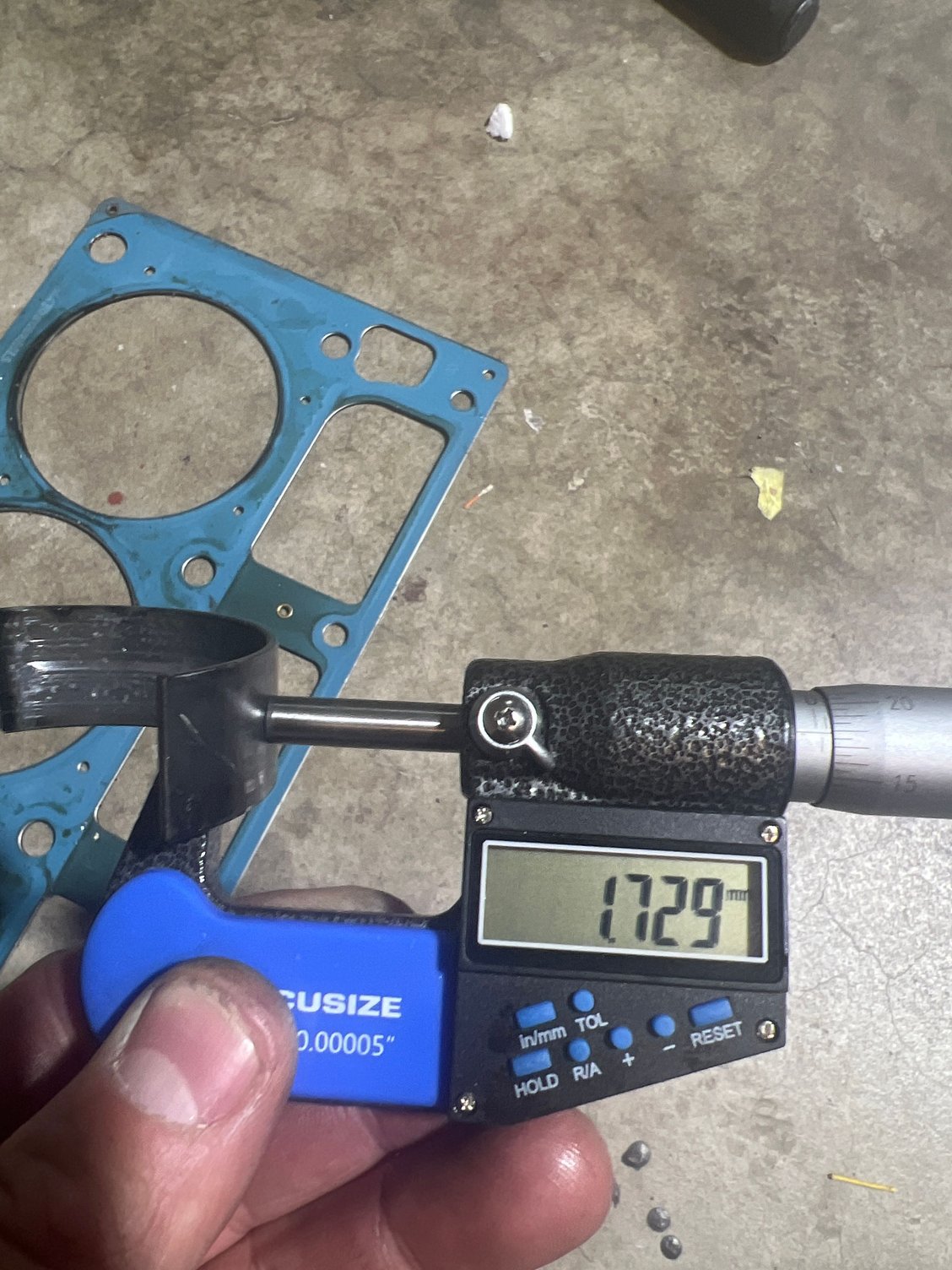

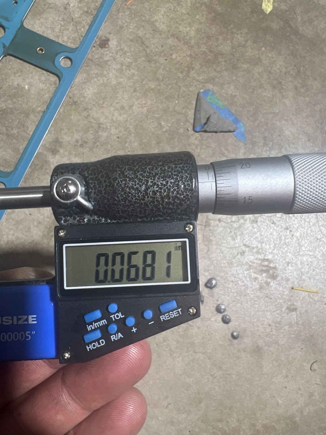

head gasket measured between 1.45 and 1.71 in a few different spots. I believe the combo was Scat rods, eagle crank, and Summit .020 pistons. The guy I bought it from was mostly the money behind the project, and knows some stuff but nothing too technical. It actually had a 255lph Walbro pump in it 🤦‍♂️. Can you explain what you mean by in the hole? I’m not familiar. I can whip the plasti-gauge out tomorrow, but looks like the bearings are 1.7mm thick. The block wasn’t honed for the ARP main bolts, so I doubt any of the rods were checked. I think the guy just ordered parts, slapped it together and hoped for the best. Considering a dry sump, and don’t mind if it’s more maintenance. This isn’t a daily but I’d love to go out and stomp on the go fast pedal without worrying.

And to add on to my novel up there, it seems like the bolts were torqued slightly different. Some broke loose with a gun, others had to be loosened with the jack handle with my feet almost coming off the ground. Head gaskets look inconsistent too.
