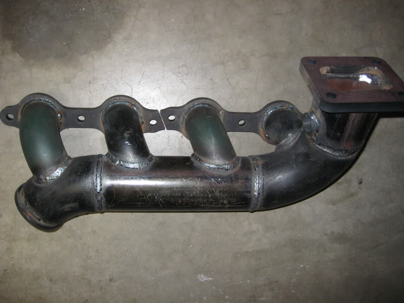

This is what I build, have sold many of them. It's secd 40 steel pipe and weldels. Holds up quite well.
Secd 10 is .120 wall
Secd 40 is .203 wall
