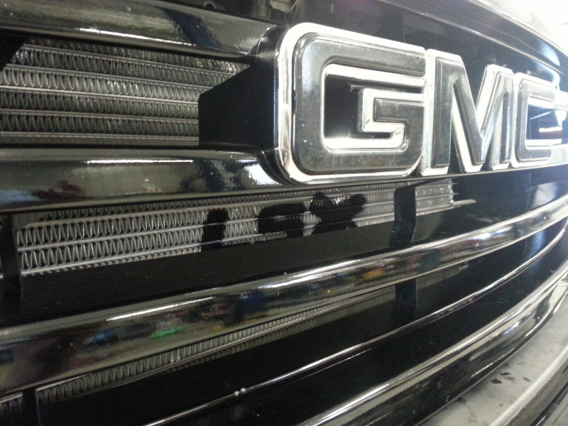

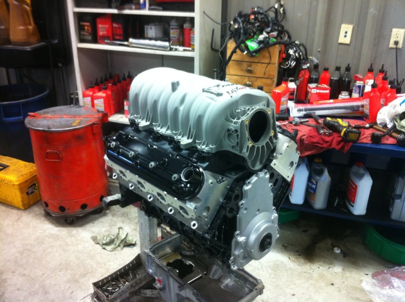

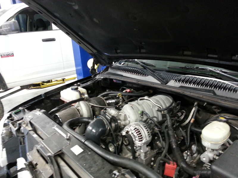

I posted a while back when I was getting together well now it's done and running pretty good.
Stock lq4 Texas speed cam prc 6.0 heads fast lsxrt intake 76mm turbo
3200 circle d it made 550/548 on flaco's dyno on 6lbs of boost.
I can't any any track times worth posting about. It leaves the hole so soft its not worth running 2.3 60foot times lol.
I have out ran a 12.0 camaro on the street from a roll.
Onto the pics

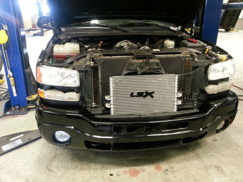

Got a bigger trans cooler also lol

2.3 60' with that stall??? That seems a little high

Its a very tight stall and on a slick I got the 60 to a 2.1 brake boosting i couldnt even get 1 psi out of it on the line.

you need a 2step. with my msd 2 step i build 6psi on the line. setup is 5.3, cam, 76mm, TH400, 3000 stall and 3.42's

What size size turbo is that. I know you said 76mm but that doesn't tell the whole story.

Shoot a 100hp shot to it out of the hole. Fix that 60ft right up.
