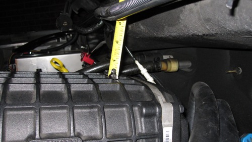

Sign me up for the bigger in Texas size 200+ hp version on my Avalanche with LS6 and TVS.
Attached Thumbnails Large intercooler for Maggie's.  Is there room??-img_1440-copy-2-copy.jpg

IC is designed and awaiting the core. I took a look at an 06 truck the other day with a 112 on it. There is a HUGE amount of room back there I was blown away, thought it was close from looking at pictures. Hope to have some pics in a couple of weeks.
The spacers are designed just that should help some. I would be really surprised if we did not get some 30-50 ' cooler temps with this new core. time will tell.
The 1900 is next on the list. Those things have some much room left of the table its not even funny.
Anyone have a spare set up laying around and want a good price on the first one let me know.
I should be in the Houston area real soon and could save on freight.

Oh no, the 112 will be done as soon as possible. Just off the phone with the core mfg. They are working on getting me the core I spec'd out. There is alot of down time waiting on stuff to show up, so If I can keep one project rolling into another while I wait it sure helps me out. lol.
Could you get me a measurment off your Tahoe. Under Cowl to Jtube. The 06 I could put my hand in there with NO problem of any kind. If you could PM the data that would be great.

I won't be back in town with my truck until tomorrow evening, but I will get that as soon as I am back and shoot you a PM
