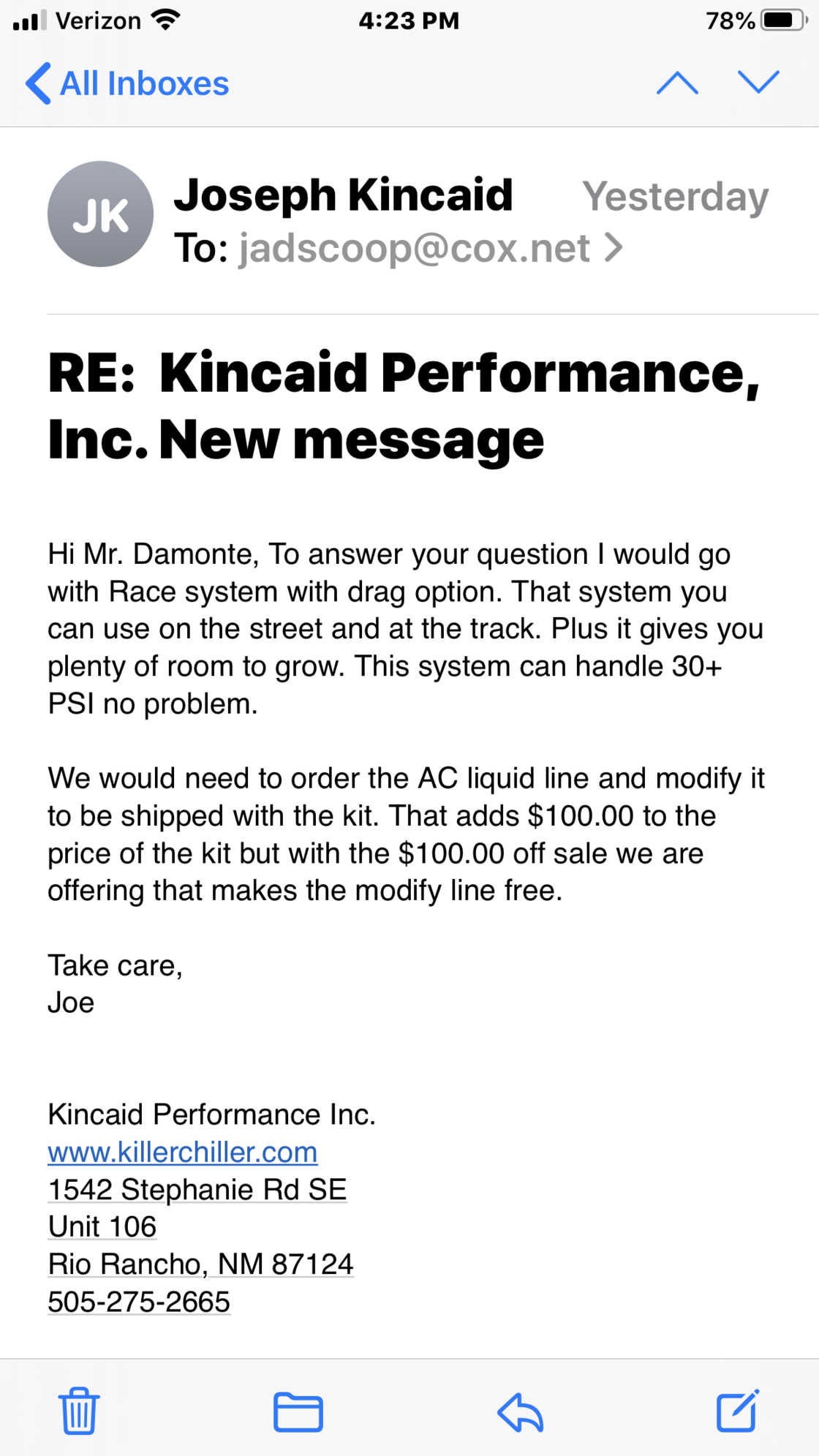

Old Oct 1, 2020 | 05:08 PM

Lmao those guys are local to me. Gonna have to look em up. Maybe pip my head in and harass em
please let us know what you think of the system
