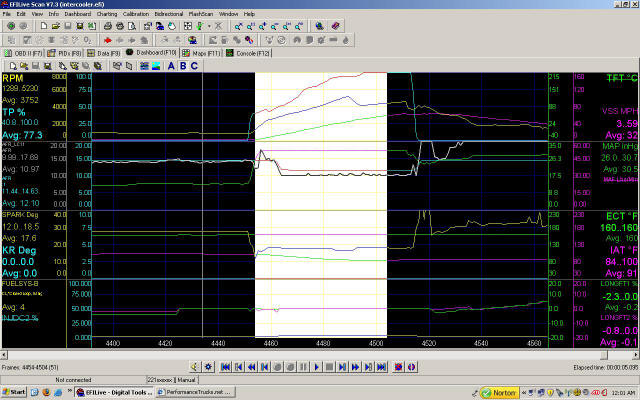

As long as I am reading it right I am seeing a average of 91 correct? Droping into the 80's abount mid pull. What were the outside temps?

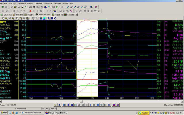

You are correct it starts at 90 and drops to 85 during the pull. The outside temperatures were 55. Attached is a screen shot of a run in march when the outside temps were 60, the IATs initially were 108 and peaks to about 150 during the run. You can see the timing pulled by the PCM. What a difference. Note the 0-60 logged at 5.8 before the intercooler. Now Im curious about an air/water hmmm

Hey it will be nice to keep the IAT's under 100 degrees all the time.
