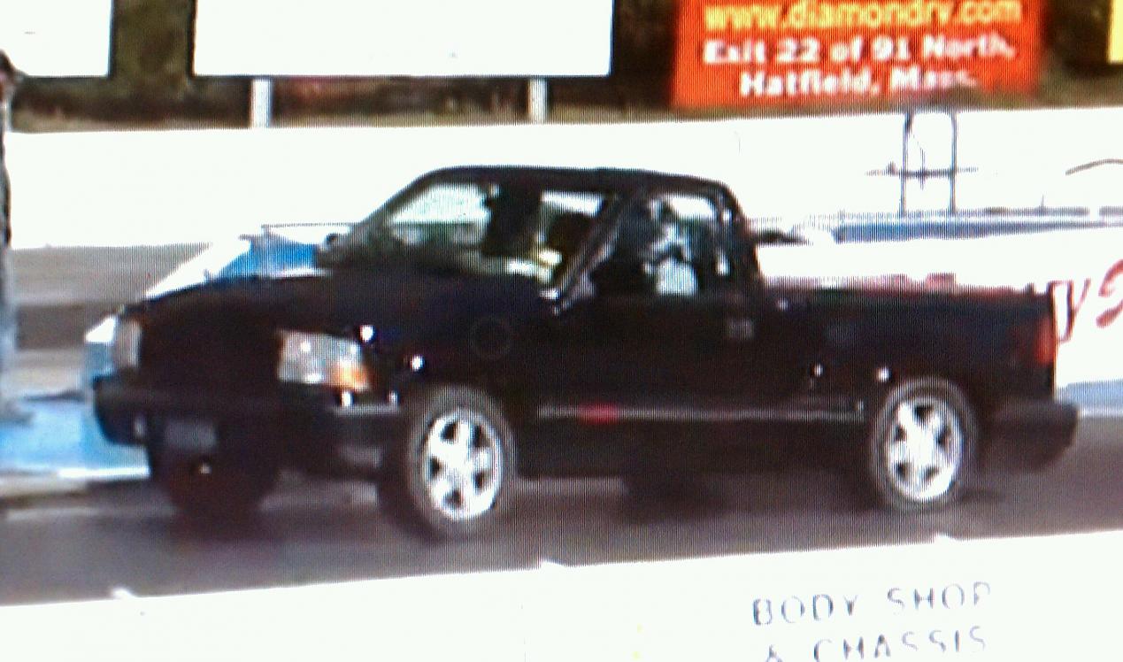

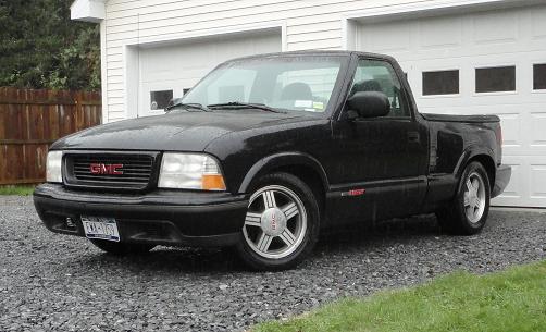

thats also understandable, i dont expect to duplicate the same numbers. i absolutely hear what you are saying, i just wanna make sure theres reasonable evidence that this style setup will work, with relatively similar success...
i dont plan on making near the amount of hp he did, but looking for similar 1/4 mile e.t.s (high 9's) and im hoping it will be attainable because my truck weighs at least 1200 lbs lighter...
im working with a 99 reg. cab sonoma, LQ4, 4l80e..
so far with stock toque converter and a 150 shot it went 11.57 @116
Attached Thumbnails KB Racing Turbo Hot Pipes kits NOW AVALABLE!!-029.jpg   KB Racing Turbo Hot Pipes kits NOW AVALABLE!!-ls1tech.jpg
KB's kit will make as much power as you want. With correct setup you be able to go a quick as you are wanting. You also have to take into consideration Jerret is 4wd running 4 ET streets. Your gonna need some good suspension work to put all that power to the ground and make it stick. So just cause you are lighter isn't a good comparison, kind of comparing apples to oranges.
Old Dec 10, 2010 | 07:38 PM
  #90
91blowthru's Avatar
Joined: Sep 2008
Posts: 273
i guess my question is more about the power potential, and you guys helped with that.
im not too awful worried about hooking the lighter, two wheel drive...
im not bragging by any means but it 60 footed a 1.70 with the stock third shock "traction shock" setup and a smallish 255/50/16 drag radial, with the 150 shot off the line, i plan on using cal-tracs and adjustable shocks this time around.
i dont think ill be using a trans brake, not at first anyways, which yes i know would be leaving some potential on the table...
we'll see how foot-braking it goes with a "small" tc78 turbine and a 3600-3800 converter....
id like to trap 140mph if nothing else.
this is a 7-day-a-week daily driver...
