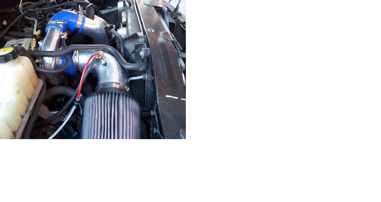

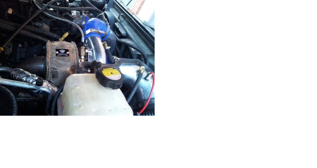

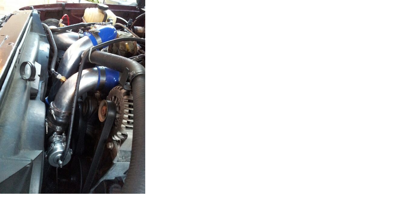

Well I finally got everything done - The turbo is in and made the switch from Kennebell 2.8 to Turbonetics 7575. Im sure you folks are already aware of the differences - The supercharger was more violent causing some good torque steer at the start. The turbo his a slight delay due to lag but catches up very quickly and pulls past the charger at some point in time. I was thinking of bolting on a procharger on the other side to get out of the hole quicker - any thoughts? I would plum the charger in parallel but use a separate intercooler.

what are you spraying pre turbo?
Old Sep 28, 2014 | 10:04 PM
Joined: Aug 2004
Posts: 682
From: Ontario
The meth is sprayed pre turbo

Spray the meth post intercooler.
^^ right. I never seen meth sprayed into the turbo, esp on this site. All nozzles are about a foot away from the throttle body
Some of the folks at LS1tech are spraying pre turbo - I'll check it out some more - should be easy to change!

I've only seen it pre compressor if there is A) no intercooler and B) concern for Temp of the blower or turbo itself.
I would think your best bet is post.

Im still thinking of how to plumb the procharger on the other side - I'll try it in parallel first with a separate blowoff so I'm not over pressuring the turbo with the supercharger
