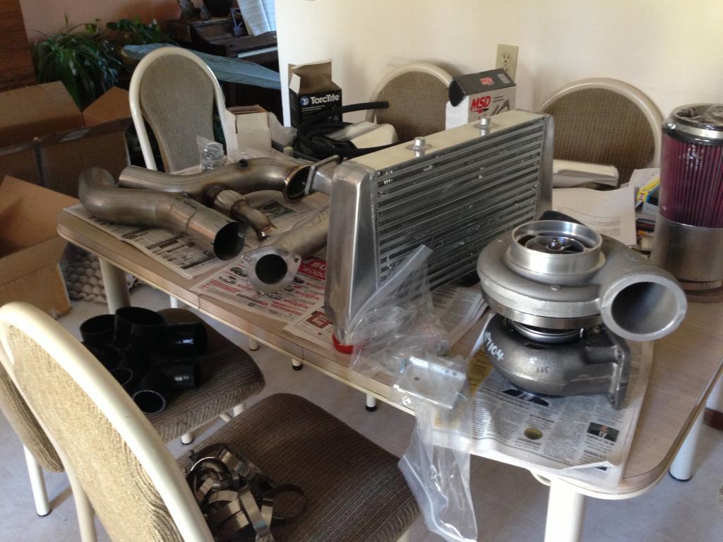

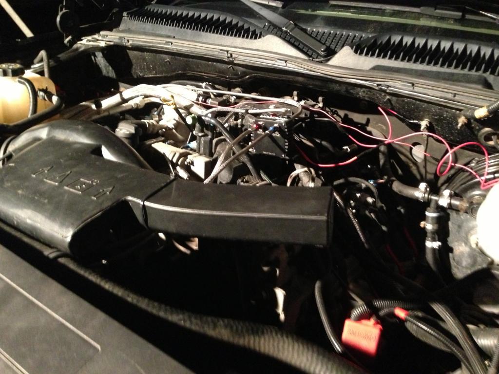

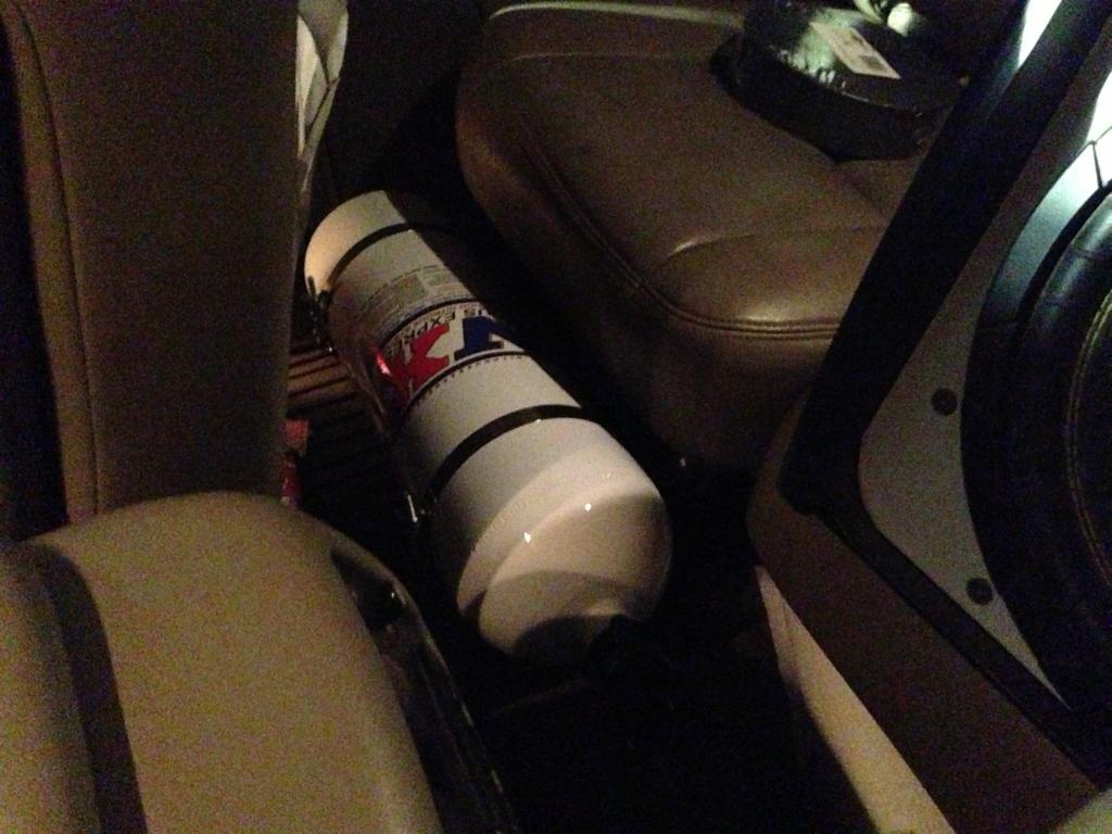

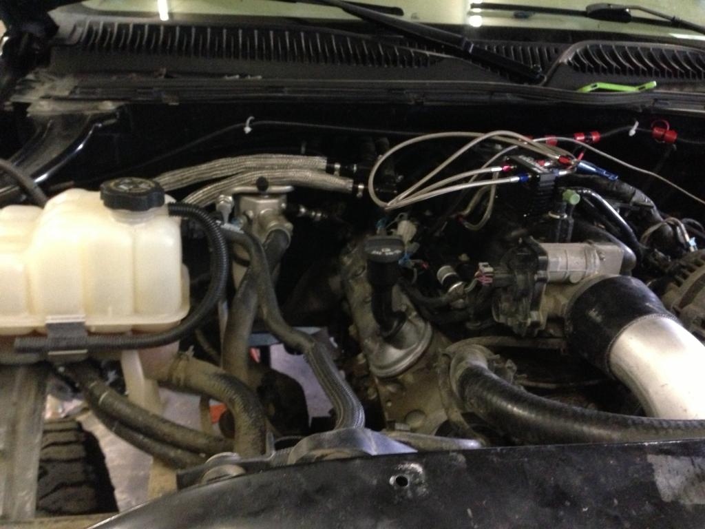

alright so update time i guess. i got bored waiting for the turbo kit so i ordered a nitrous express wet kit and threw that on

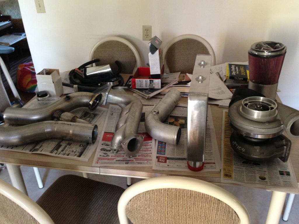

i made a timing retard box out of a couple relays and ran a 100 shot. kept me entertained for a couple weeks till this showed up =)

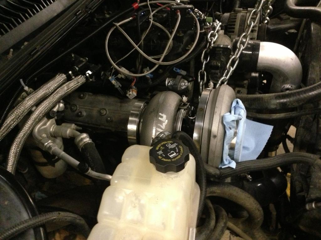

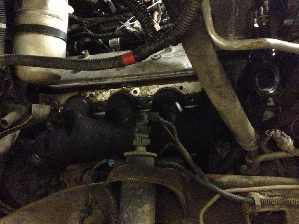

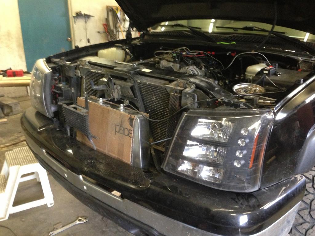

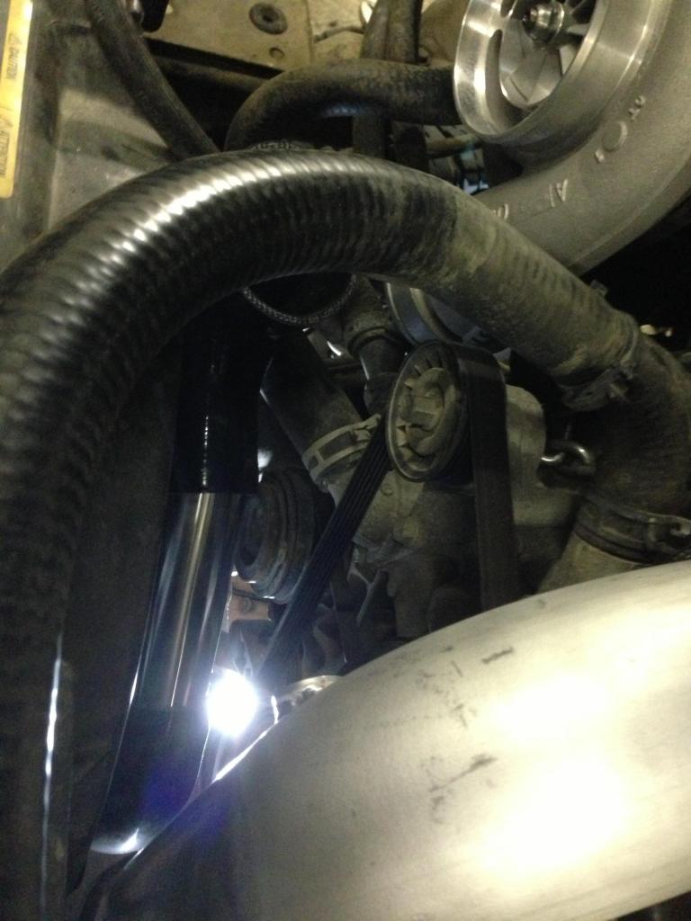

i went pretty nuts on it and had it on in a couple days. its a pretty well built kit everything went together smooth. i bent the **** out of my ac lines to get them where i wanted but it im happy with the result. i was smart and put a screwdriver through my ac rad which worked out not bad because i could wrap my ac line.

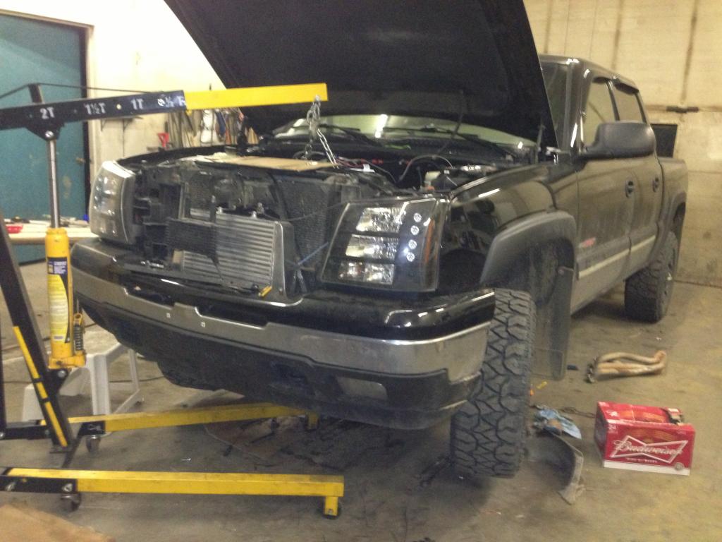

i dont have my tru cool 40k yet its in the mail but its getting mounted in front of the intercooler.

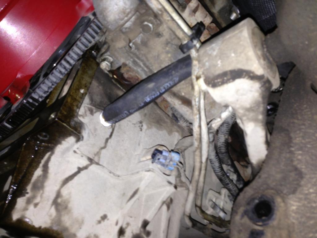

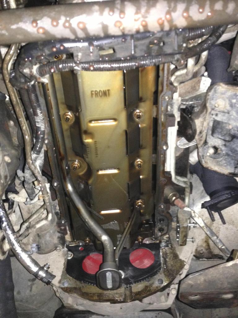

to get the oil pan off i tried lifting the engine up but it still didnt clear so i just dropped the front diff. made lots of room to get the pan off

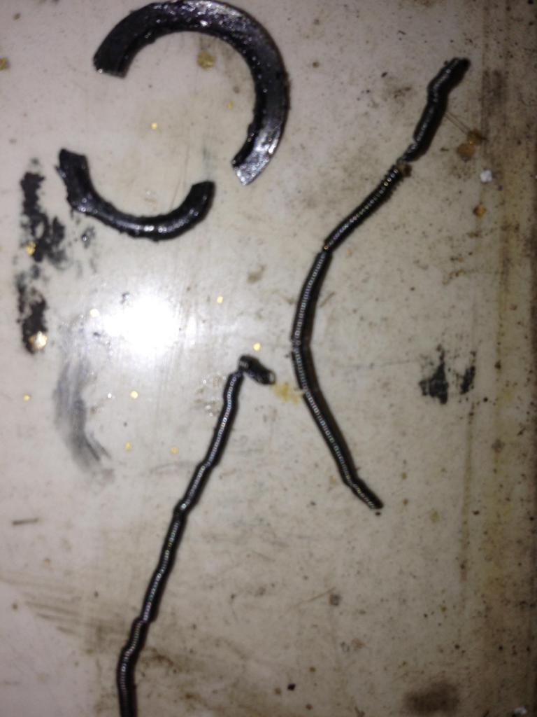

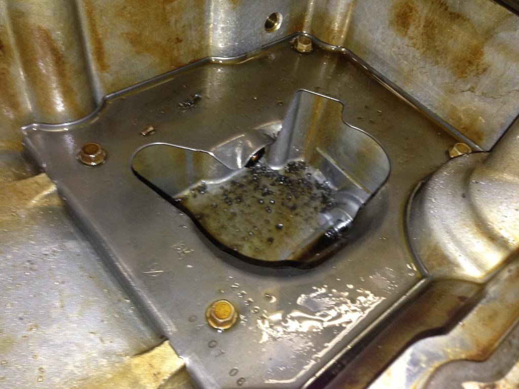

its a good thing i pulled it too. i found my poor abused LQ9 hasnt been having a good time.
the fine filings are from drilling and tapping it but i found this
my valve stem seals were coming apart. so i pulled my valve covers and found more springs and washers, changed those, did a melling high volume pump while i was at it, and drilled and tapped a 5.3 pan i had laying around because i didnt like the way the first one came out.
this is how the oil drain came out. it seems to work well it doesnt blow smoke out the tailpipe.

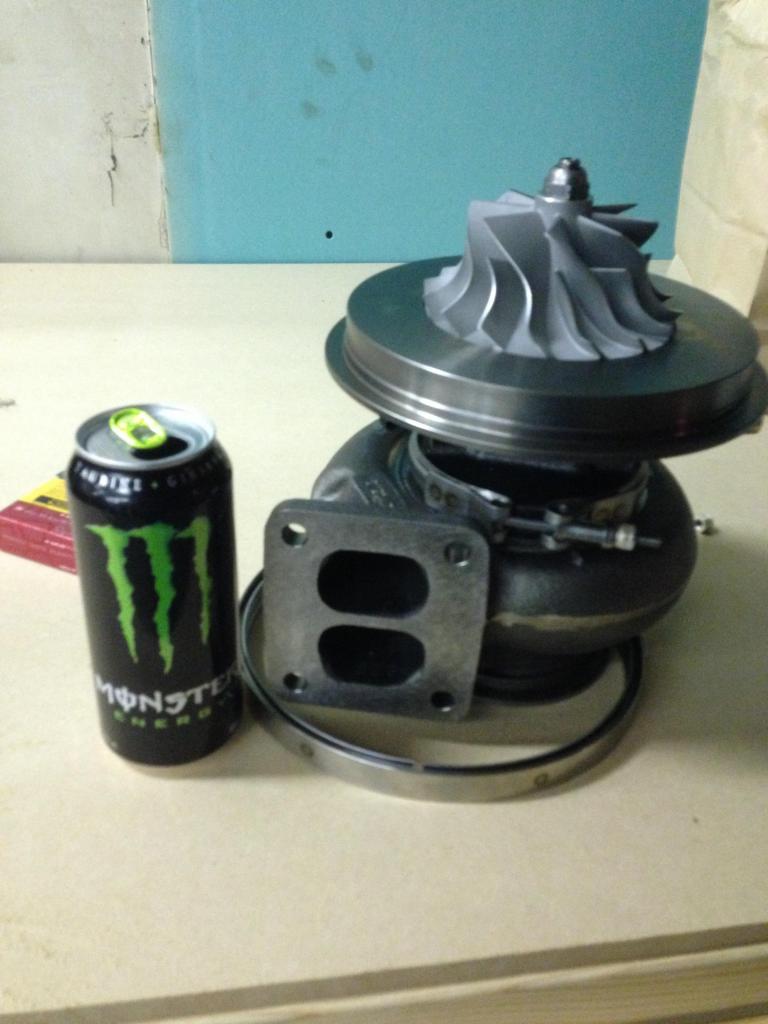

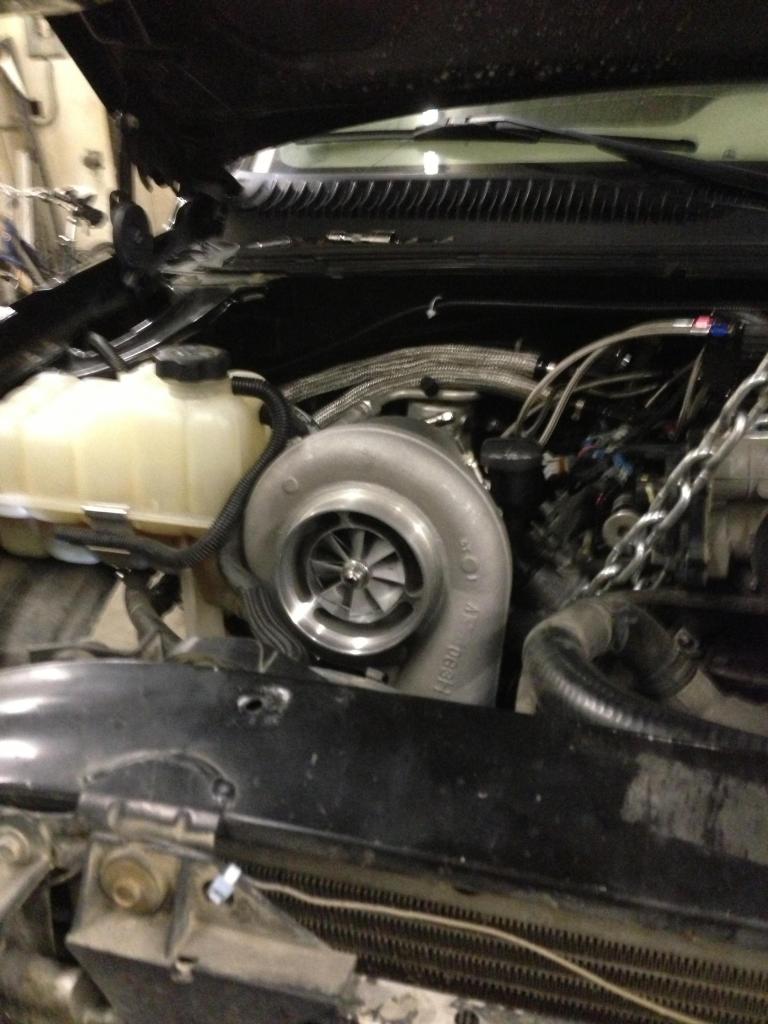

all in all very happy with how it came out. still need to clean up some wiring, finish tuning and do some tweaking but it feels good. it was making 15 psi before id let off with the 6lb spring in the wastegate so idk whats going on there. 3 lb spring still made 10-12 so im going to try the 1.5lb spring when i get home from work. my trans cooler and manual boost controllers waiting for me too so ill take care of that. i dont know how far my single walboro 255 is going to get me any guesses how many psi before its maxed out?it spools pretty quick for an 80mm and it sounds awesome. im just running open downpipe right now but planning to try make a 4 inch dmax exhaust with an electric cutout work. ill post links to youtube of it running. when i finish tuning it ill get some good burnout vids =)
any questions or advice anyone has im open to. im 20 and still in the learning stages but i plan on maxing this turbo out on a forged 408 next year

Looks good
How do you have your waste gate vacuum lines set up?
That's a huge difference in spring vs actual.
Sounds like the bottom side of the gate is missing its plug for the second port.
